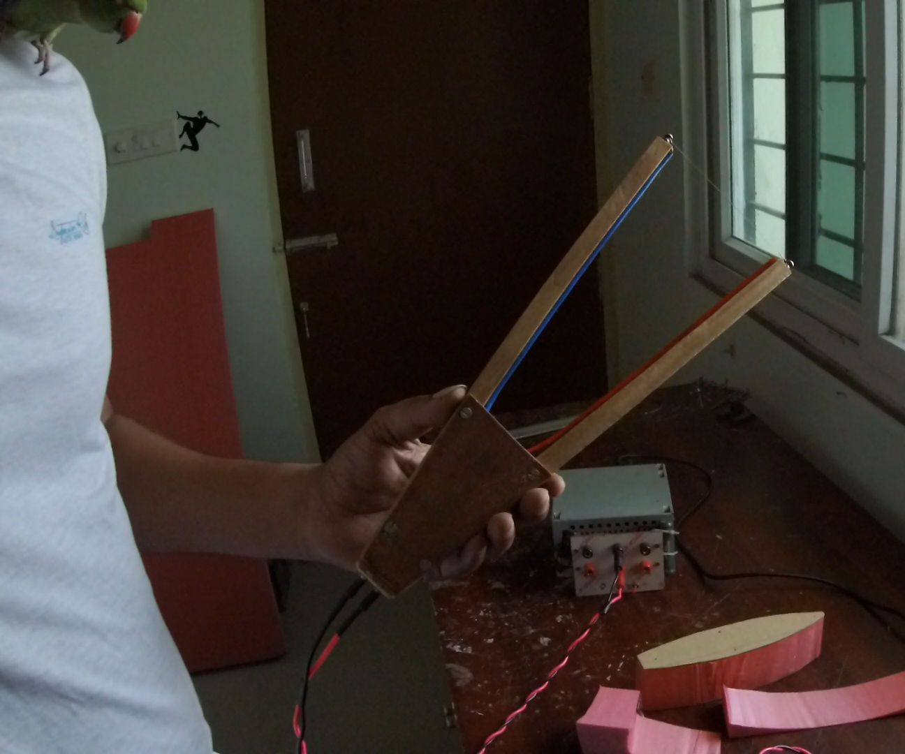

So I made a variable depth hot wire foam cutting scoop tool for making slot/ hole or to cut foam boards at any angle.

Step 2: Preparing Wood Strips
Cut the wood strips for below dimension. (you can vary the dimension as per your need)
There are four strips
  1. Main support strip - 70mm
  2. Spacer strip - 45mm
  3. Sliding strip - 55mm
  4. Bottom support strip - 30mm
Use 4mm drill bit to drill as per the shown in the 2nd picture and make a slot in the sliding strip as shown 3rd picture.
Pitch to pitch distance for main & spacer strip is 25mm and 8mm for sliding strip
Use your dremel router bit to remove excess wood to fix the nut as shown in the 4th picture.

Step 4:
Solder the wire with lug and 3.5 mm male connector and fix it with shrink tube.
Fix the soldered wire to the sliding strip using quick fix.
Fix the bottom support strip to main strip using quick fix.
Step 5: Now Assemble It!
Now fix the nichrome wire profile into sliding stip, and fix the sliding strip on the main support strip.
Paste a graph sheet for easy measurement on the side.
Your HOT WIRE SCOOP TOOL is ready!!!!!!
Step 6: Nichrome Wire Profile
Use 22 SWG nichrome wire. Its more optimum to use this wire since its rigid and gives clean cut without much deviation. You can simple bent the wire using nose plier.
