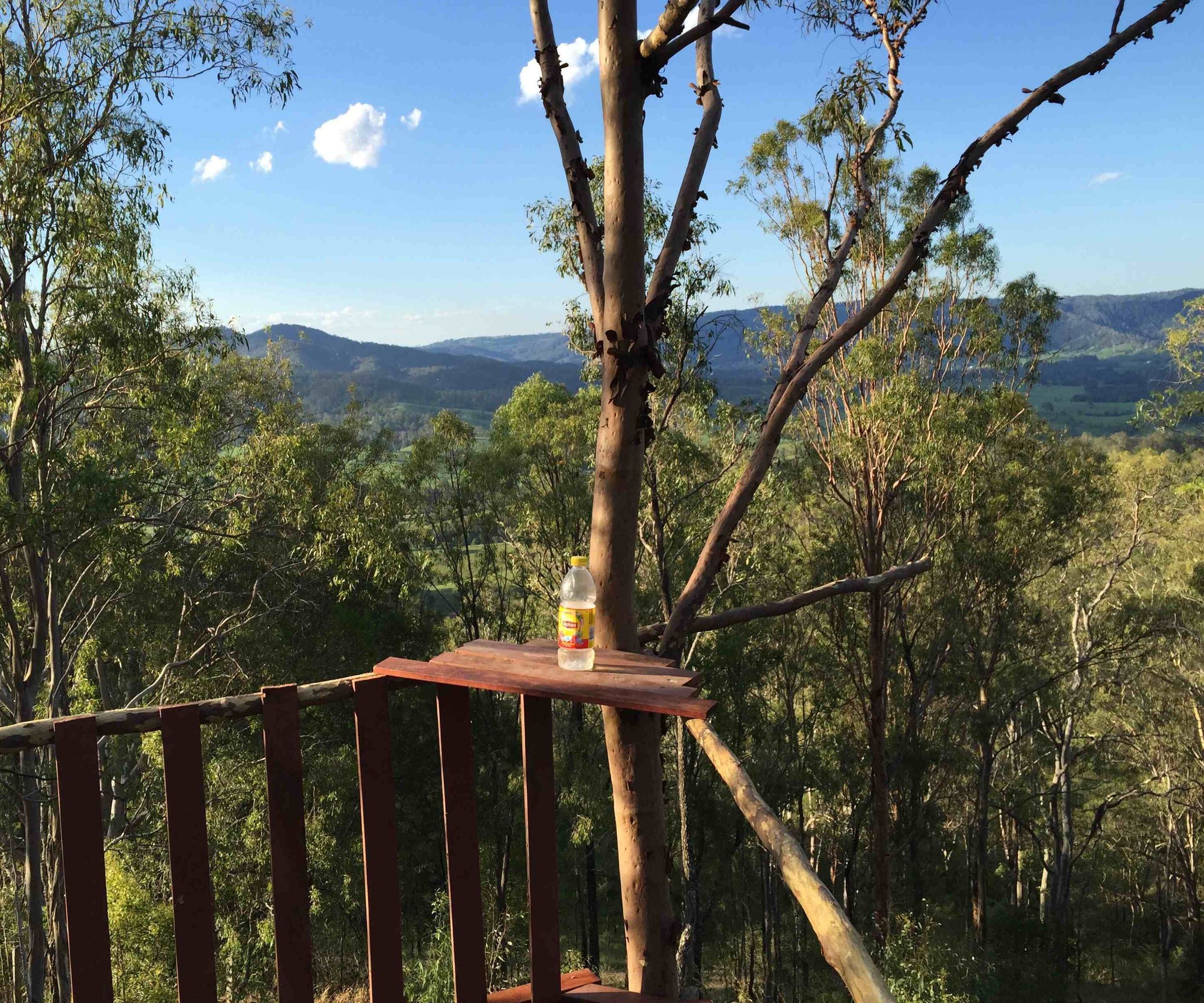

Now, I've made bar tables, coasters, platters and a multitude of wood things, I love staining with olive oil, I always find the cheaper the better and if it's indoors it lasts for years, I've also stained a BBQ and it's been going strong in the Australian climate for a year now,
Grab a standard kitchen scoured and apply oil liberally with the sponge side working it into the grain, I couldn't believe the finish it came up glossy but deep rich red, looks absolutely beautiful
