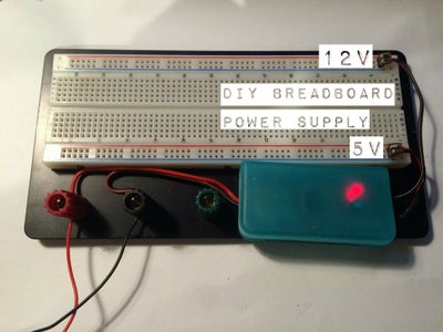

In this project I´m making an 5v and 12v power supply for the Radioshack breadboard. his
Step 1: Parts
The parts I used for this project is:
* 5v to 12v step up
* Wires
* Small project box
* 4 male pins
* PCB
* Breadboard
* 4x battery holder / USB cable
Step 2: Make It Fit
My 5-12v step up did not fit in the box I have so I had to cut off the wire connectors and solder the wires to the board instead of screwing them to it.
Step 3: The Power Connectors
Solder two male headers to an 2x2 PCB and than the + and - cable to the pins, do that to both cables.
Step 4: The Box
Make two holes one one side of the box and one on the other side, the holes have to be big inouf for the cables.
Step 5: Soldering
Take 6 wires and solder 4 to the input and 2 to the output.
Step 6: Mounting
Screw the two input wires to + and - on the breadboard connectors, and connect 5v to the red and black connectors.
