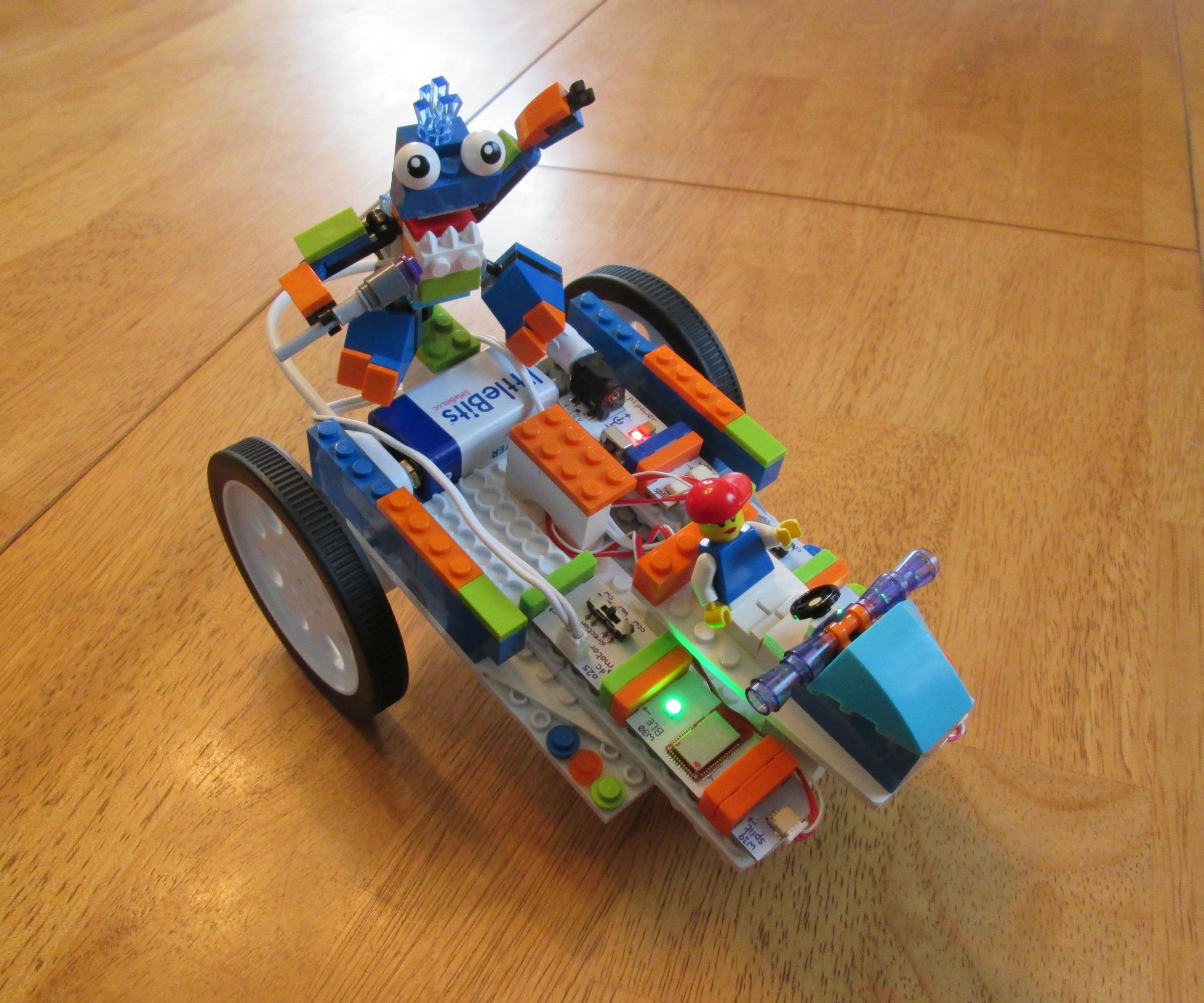

Introduction: DIY LittleBits
Let's make DIY littleBits! For original circuits, visit littleBits.cc
*Added since initial publication: light trigger* I change the original circuits based on parts availability and my own preferences and ability. I volunteer for the Fresh Air Fund, and my hope is that I can learn enough to offer a free afternoon workshop this summer for the children who visit my town just 45 minutes north of NYC.
The connection method I currently use between bits involves 3 header pins on both the left and right sides and female to female jumper wires. There is no kanban mechanism to prevent miswiring, so the user must be careful when connecting DIY bits. One idea is to use alternating male and female pins on alternating sides with male to female color coded jumper wires (red=+VCC, green=signal, black = GND). If you decide do use alternating male and female pins and jumpers, then the male header pins should be on the left of the bits; this is to prevent dangling live male jumper wires from crossing each other and creating a short circuit.
PARTS: If not stated in each individual step, you will need solder, hot glue, 22 gauge stranded insulated wires, perfboard, male (maybe also female as you like) pins, jumper wires, heat shrink tubing (electrical tape is ugly but will suffice), and a method for labeling your DIY bits. Many bits require an op amp chip, which can get pricey if you are buying them individually from the store. I recommend buying larger quantities of chips from www.digikey.com. The Digikey part number for the LM741 op amp chip is LM741CNNS/NOPB-ND ; at publication time, I was able to buy this chip for $0.70. EDIT: I have learned from electrical engineers that it is better to use a rail-to-rail op amp, such as the TLV2462 available at Adafruit - please adjust pin numbers based on the white paper of the op amp you use. For labeling bits, I use #6 plastic from the recycling bin (also sold as shrink film by www.digikey.com.
Tools required include wire stripper, soldering gun, helping hands, needle nose plyers, hot glue gun, and a method for cutting perfboard (I scored it with a sharp knife and snapped it over a straight edge ruler, but some prefer to use a dremel). The most important tool is a good book; I recommend Timer, Op Amp & Optoelectronic Circuits & Projects by Forrest M. Mims III http://www.forrestmims.com/engineers_mini_noteboo...

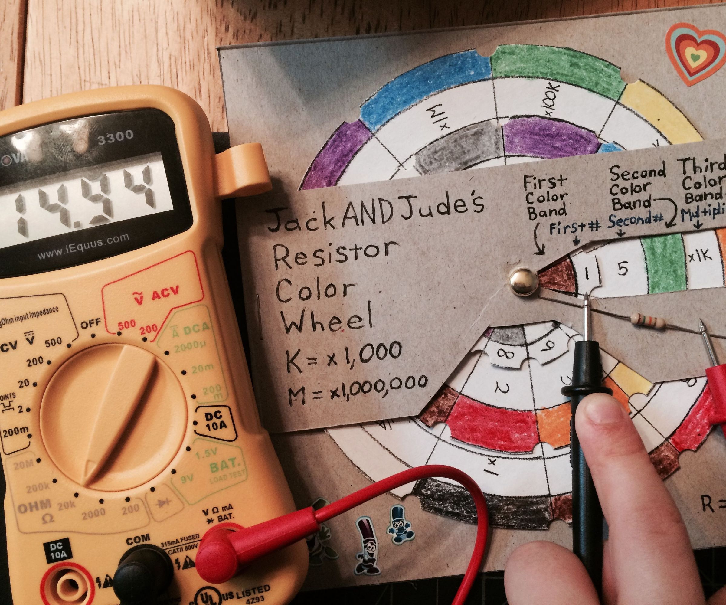

Step 2: RGB LED - Light Sensitive!
Parts list:
1) Perf board cut to 9 x 12 full holes
2) LED: 5mm tricolor (red/blue/green) - Radio Shack part #2760028
3) Resistors: 3 x 330 ohm (220 ohm may suffice - test it on a breadboard first), 3 x Cds photocells (photoresistors) - Radio Shack part #276-1657. I used the 2 large photoresistors that come in this pack for Red and Blue and the medium for green.
4) LM741 op amp - Radio Shack part #276-0007 or Digikey part #LM741CNNS/NOPB-ND ... The output pins on the 741 differ from the LV321, which is used in the original littleBits.cc schematic for this bit. Please note the difference!
5) connection pins (3 on left side and 3 on right side)
6) heat shrink tubing
7) 3 jumper wires
Optional:
If you are not interested in making your RGB LED light sensitive, then you will need 3 10K potentiometers instead of the 3 photoresistors.
Procedure:
1) Breadboard and test that your LED can make the 3 main colors and a variety of other colors in between. You can do that by either covering over the photoresistors with different opacities (black electrical tape is almost totally opaque, while your fingertip is probably 1/2 opaque) or, if you used 10K potentiometers, use a flat head screwdriver to dial in your colors.
2) Arrange on perfboard & solder.
3) Test that V and S output 5V against G.
4) Hot glue any weak connections, including the pins to the perfboard.
5) Make a label and consider color coding this bit according to the littleBits color code. LED's are an output, so this would be green. Lego's anyone?
6) Great job! I put in front of the TV to make a mood lamp. Imagine placing the photoresistors beneath a motorized device that blocks the light from another LED in a dynamic intermittent manner.
