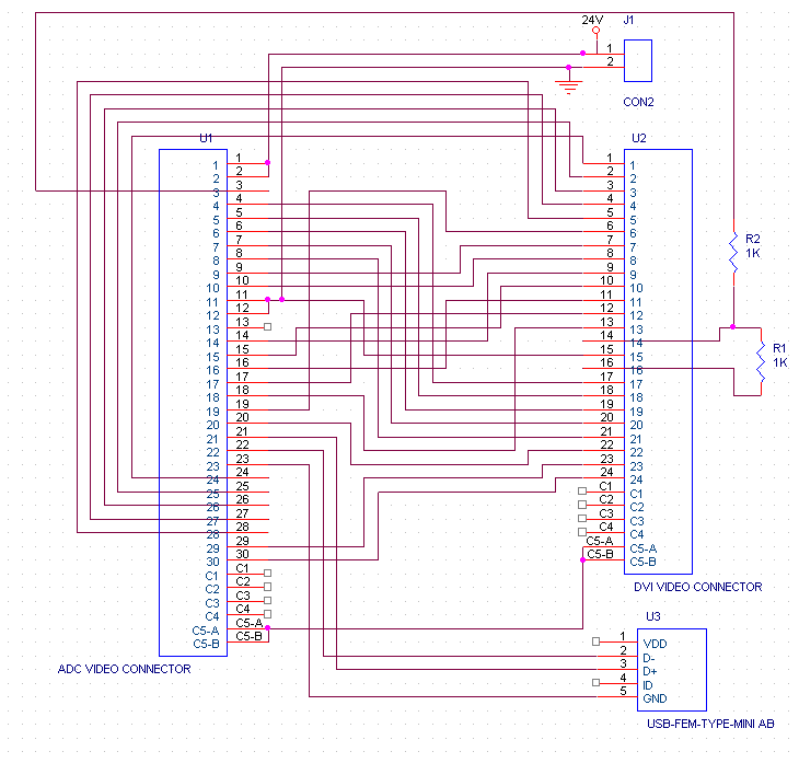

The version 1.0 of the prototype is this:
Connected all the pins indicated in the apple datasheet and put a mini AB USB connector (mostly because of the small size) as an interface with the PC. I salvaged a DVI and a ADC connector from an old broken video card and put them to use in my project (that is why they don't look brand new) but they work just fine. Set up the software to control the intensity (only in Windows) developed by some guy, who Tony describes better than me in his blog. After that, connected a DC power supply of 24VDC and at least 1.3Ampers for a monitor of 17" (bigger may require more power...amperes not voltage) and presto!
The details:
As you can see in the pictures the PCB is quite small and the most complicated part is the wiring since the pins of the connector are very close to each other and there are not PCB footprints for ADC connectors so I had to design my own. Although, I tried to be very careful making sure the pathways of the power were far from the others, I made a mistake with two wires from the USB that I had to correct breaking the pathways and rewiring them with two external cables. Not the best job ever but as a lesson "don't ever send a PCB layout at 3am". Other than that, the circuit is pretty much plug and play, solder the connectors, connect the cables, connect the power supply and you are good to go.
What is left:
Well, as you can see in the diagram, there is a softpower pin that I left disconnected but it doesn't seem to affect the operation, I have to do some research about it.
A VGA connector will be added in a future version so you can chose if the input is DVI or VGA
I don't know exactly where I am going to put it but the idea of the altoids box sounds good to me for now. Any idea guys?
