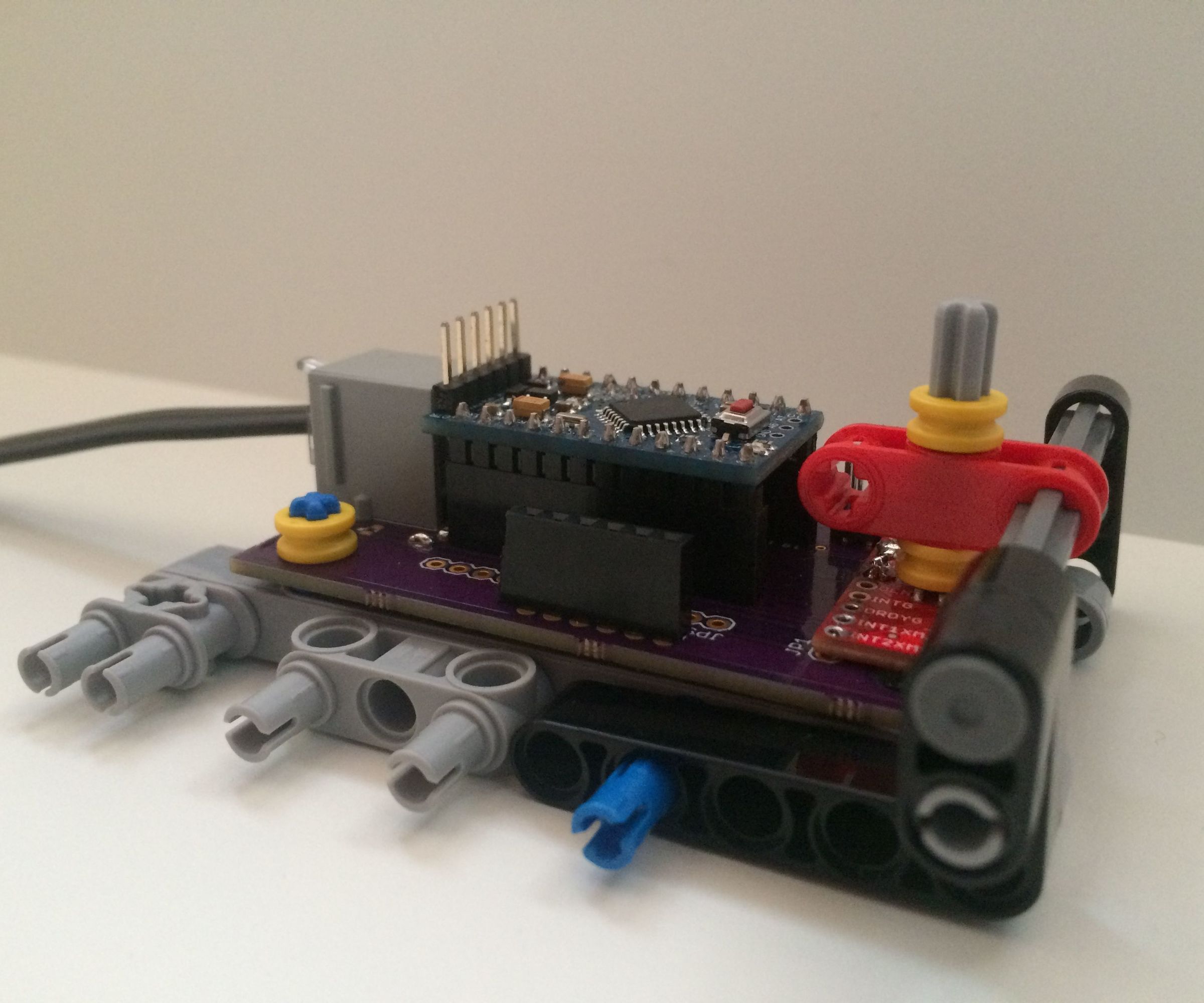

Fit the new smart PCB with the sensor through the hole drilled out in a previous step
Build details here Github link for PCB
Step 7:
Refit the heat exchanger and connect the PCB up, install the HTU21D humidity sensor board in the intake channel and connect to PCB.
Step 8: Reassemble the Two Halves of the Shell
Reassemble both halves back together and the dehumidifier is now ready for use, make sure that the window temperature sensor hole is facing the centre of the window pane.
