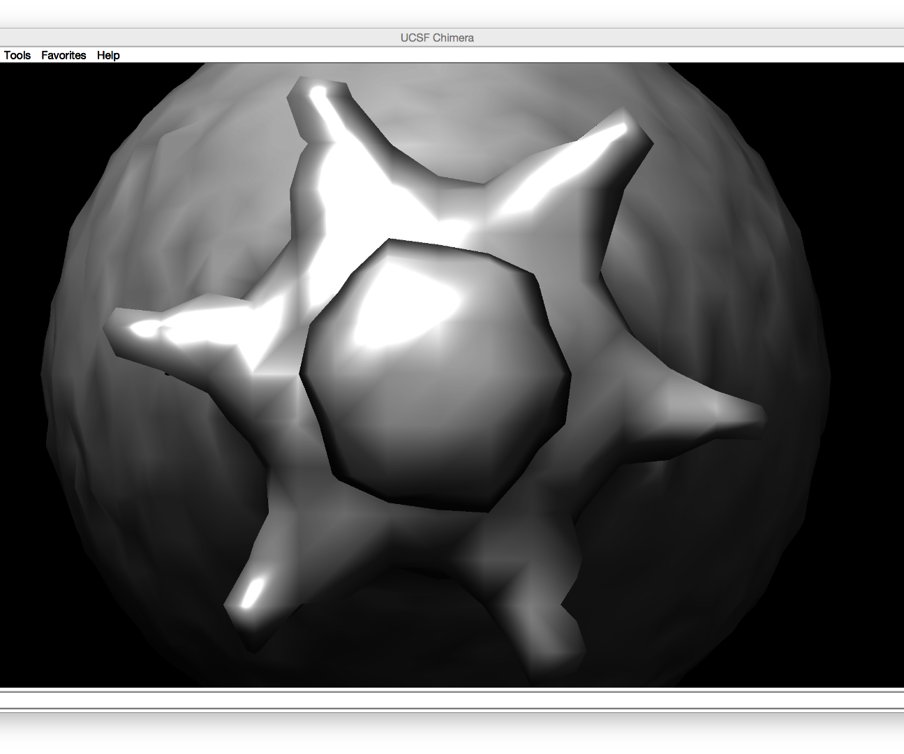

After designing in cadnano, we wanted to visualize our designs. We encountered problems when trying to convert the cadnano representation of the nanostructure into an atomic representation for visualization in the standard VMD software. As a result of this struggle, we built a small module to translate cadnano .json files into the .mmcif format, and then used that to extend the Autodesk Molecular Viewer to accept cadnano file uploads. These mmcif files are the new industry standard for atomic representation and can be used for visualization of large scale models which could not be handled by the old PDB models. The 'A' design was converted to a .mmcif file by simply uploading the cadnano .json file into the Molecular Viewer via the upload portal. Using the viewer was helpful in determining where each staple stand was located in relationship to the larger model itself.

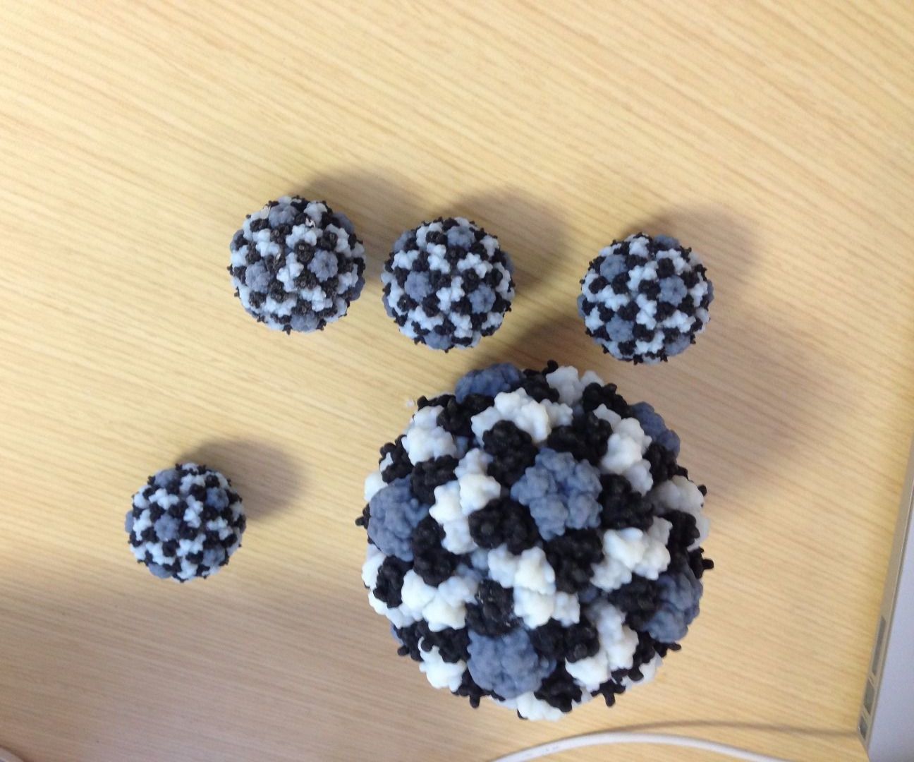

Step 9: Print and Feel the Data
Once we had finished the process, we wanted a way to better understand the data. We wanted to feel the data, and so we developed a way to 3D print the atomic force images as a topographic map. This allowed us to touch and feel the height of the A on the surface. It helped us illustrate the noisiness of atomic force microscopy and also helped us grasp of the AFM worked by measuring a height profile.
Processing the Image Data for Good Conversion
While just the raw TIF data from Gwyddion can be used for conversion, it has a lot of height variation due to the small pixel count which can make the result very spiky. We decided to do a blur step with a small window size on the image to smooth out the data while maintaining the overall feel. Also, it's very common to have large height artifacts in the AFM data, for example when salt crystals land on the surface they can be quite a bit taller than the origami, so we also did a max height filter to cut off those pieces and provide better contrast for the resulting print.
These two steps were accomplished using some basic Python programming and the PIL image processing library, though they could be easily done on a single image using any popular image editing software.
Converting Images to STL
First, we converted the grey-scale image to STL using the Heightmap2STL.jar script. We downloaded the script and placed in in the appropriate directory. Using terminal we ran the command
java -jar heightmap2stl.jar 'path to imagefile' 'height of model' 'height of base'
and we played with 'height of model' and 'height of base' until we had turned the parameters to an acceptable standard for 3D printing. We used 'height of model'=50 and 'height of base'=1. The conversion was very fast (on the order of 2 seconds).
3D Printing
Once we had a valid STL, we loaded the mesh file into Autodesk Meshmixer where we scaled and repaired the model. With the repaired STL file, we successfully printed the file on a Stratasys Objet Connex500 using Vero Clear resin.
It is also possible to use Meshmixer to send the print directly to Shapeways where it can be configured with many material choices.
