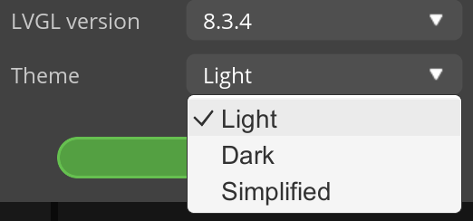

Step 4: Color Theme
Many real watch faces are light background. And since LCD is using white backlight, light theme should be more "energy efficient" logically.
In contrast, many LCD UI designs are dark theme. One of the main reason is it can hide the black border and make the screen looks better.
Select what color theme is subjective, but it is the option while creating SquareLine Studio new project and cannot change in the middle. So it is better make this decision at the beginning or you may need recreate a new project.

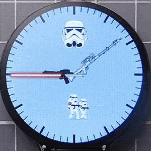

Step 6: Clock Arms
Clock arms also can draw from scratch or find on the web. If you have an idea of a fandom stuff, you can find some related clip art for the clock arm. E.g. for a stormtrooper theme, you can use some of their weapon as clock arms. I selected lightsaber as arm of second, DLT-19X as arm of minute and a short blaster as arm of hour:
- https://en.m.wikipedia.org/wiki/File:Dueling_lightsabers.svg
- https://battlefront.fandom.com/wiki/DLT-19X
- https://www.onlinewebfonts.com/icon/555311

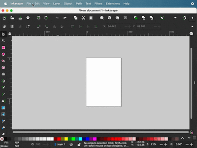

Step 8: Export PNG
The major SquareLine Studio required assets for an analog watch face are the base image and the clock arm images. Base image contains icon, clock marks and numbers, you can group it together for easier export.
Then export to PNG:
- select the export object
- select "File" menu -> "Export..."
- adjust export size, my practice is set document as 100 DPI for easy adjust export size by inches
- ensure checked "Export Selected Only"
- export to SquareLine project assets sub-folder

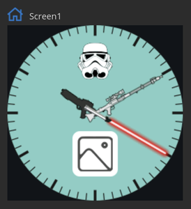

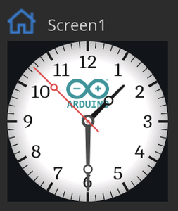

Step 9: Clock Arms Rotation
In SquareLine Studio, create a new image object for each clock arms and assign the corresponding image asset. Then:
- change X and Y value to align the clock arm to center axis
- fill different value in rotation to check the effect, the value is 10 times of degree
- adjust the Pivot X and Pivot Y value to align the clock arm to center axis in any rotation value
- export UI files to Arduino project folder
In Arduino project, you need few lines of code keep clock arms in the right angle over time:
int16_t angle = (clock_ms % ONE_MINUTE_MS) * 3600 / ONE_MINUTE_MS;
lv_img_set_angle(ui_ImageArmSecond, angle);
angle = (angle + (minute * 3600)) / 60;
lv_img_set_angle(ui_ImageArmMinute, angle);
angle = (angle + (hour * 3600)) / 12;
lv_img_set_angle(ui_ImageArmHour, angle);

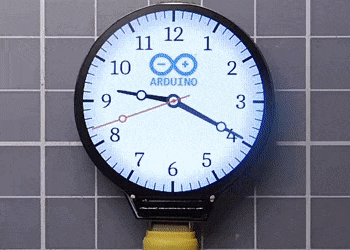

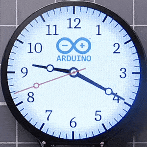

Discuss so far, there already have enough material to build the first example. Here are the source of the first simple example for your reference:
https://github.com/moononournation/LVGL_Watchface/tree/main/LVGL_Watchface_240
You may need to modify the Arduino_GFX class declaration code for your dev device:
#include <Arduino_GFX_Library.h>
#define GFX_BL 25
/* More data bus class: https://github.com/moononournation/Arduino_GFX/wiki/Data-Bus-Class */
Arduino_DataBus *bus = new Arduino_RPiPicoSPI(8 /* DC */, 9 /* CS */, 10 /* SCK */, 11 /* MOSI */, 12 /* MISO */, spi1 /* spi */);
/* More display class: https://github.com/moononournation/Arduino_GFX/wiki/Display-Class */
Arduino_GFX *gfx = new Arduino_GC9A01(bus, 12, 0 /* rotation */, true /* IPS */);

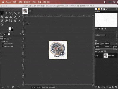

Step 15: Trim Corner
For each frame, use GIMP follow the above steps to trim out the corner (make it transparent). Then import to SquareLine Studio. Then in SquareLine Studio, create image object for each frame.

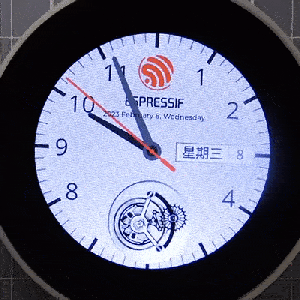

Step 16: Show Hide Routine
In the program, repeat the show and hide routine for playing this. For every loop, I rotate the images 2.4 degrees, so it looks like a continuous movement:
lv_img_set_angle(anchors[next_anchor_idx], curr_anchor_angle);
lv_obj_clear_flag(anchors[next_anchor_idx], LV_OBJ_FLAG_HIDDEN);
lv_obj_add_flag(anchors[curr_anchor_idx], LV_OBJ_FLAG_HIDDEN);

Step 21: GIF Animation
Besides imitate mechanical movement, GIF animation gives much more further possibilities. There are many interesting Animated GIF can be found on the web.
It is better select the GIF that can loop seamlessly, e.g. this stormtrooper one:
https://giphy.com/gifs/illustration-vector-xTiTnJK44NXT46iKYM
