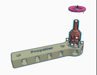

Step 10: Tinkercad Design Optional Add-on 1
Try adding a ring around your spinner.
