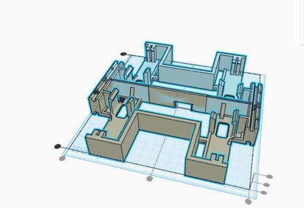

Step 1: Copy the Chassis and Cut Off the Caster Section.
Using Tinkercad, make a copy of the standard XRP chassis. Cut off the caster wheel section of the chassis using a box shape.

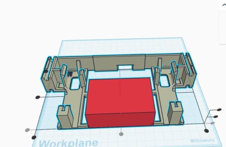

Step 5: Cut Out the Middle Section

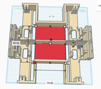

Step 6: Cut Off the Rear
Since I want the final robot to fit in an 8-inch sizing cube, I have to cut down the rear end of the chassis. The dimensions are in the photos.

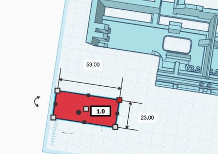

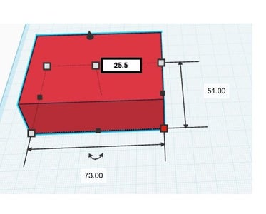

Step 9: Create a Solid Box With These Dimensions
Step 10: Align and Group With the Rear of the Chassis

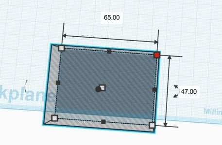

Step 11: Create a Cut Out With These Dimensions, Align to Rear, and Group

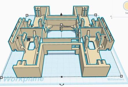

Step 16: Align the Chassis Halves and Group

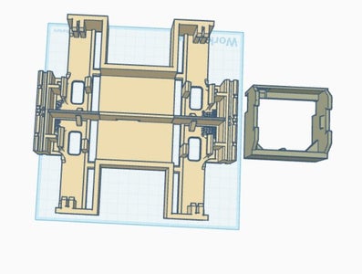

Make a copy of the board and power box

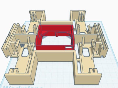

Step 19: Paste the Powerbox Onto the Workplane of the Final Chassis
Step 20: Cut Out Box From Middle
Step 21: Add Power Box to Middle and Group

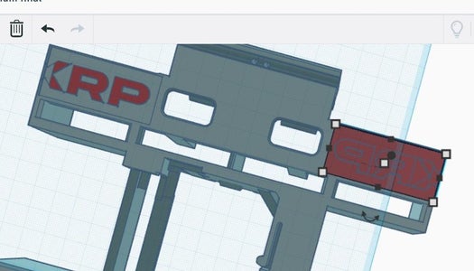

Step 24: Remove XRP Logo From Robot
Add two 1 mm high boxes to cover the logo.

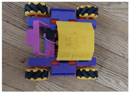

Screw the wheels onto the motors. Pay attention to the way the treads face. Attach the motor cables to the motors. Slide the motors into the chassis. Feed the motor cables up through the holes in the frame. Add batteries to the battery box and slide it into the power box. Flip the bot over and slide the XRP board gently into the power box slots. Carefully attach all motor cables. If you want to add the servo attachment, print it and superglue it to the front crosspiece.

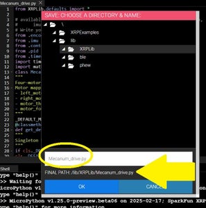

Step 27: Code the Robot

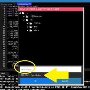

Okay, this is where my journey got really hard! There are several great online tutorials for the XRP robot, such as the Experimental Robotics Platform and the Digikey article on the Mecanum drive. Unfortunately for me, the last computer language I was proficient in was BASIC, but my brain executed a (Delete*.*) many years ago. I needed help, but was having a hard time figuring out the math and logic. I turned to ChatGPT for help. This was an amazing AI teacher. When I got stuck, it slowed down and explained everything to me like I am 63 (I am)! I highly recommend you work with ChatGPT or a real programmer to learn the ins and outs of this program. Download these files to your computer. Go to the XRP code editor and upload these files to your XRP module. They need to be saved into specific subfolders to make sure the bot can find them. The pictures show where to save each file.
Step 28: Drive the Robot Using Pestolink
Open the pestolink_mecanum.py file in the XRPCode editor. Change the robot name in line 27 to your name. Save it to your XRP.
You are now ready to drive!
Attach a USB joystick to your computer. To make this work, you need to connect your robot to your computer using a USB cable, not Bluetooth. Start at the XRP code editor and open the Pestolink_mecanum.py file. Hit run. Make sure the robot's power button is on. Unplug the USB cable from the robot.
Go to the PestoLink site. Connect your robot. Drive your robot!

I didn't like that the robot processor and all the wires were exposed, so I created a cover to keep them all hidden. This cover must be affixed with tape or Velcro because you will need access to the board to program or turn it on.
