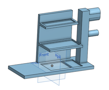

Step 1: Design Plan and Measurement Guide
Draw on paper measurements of timber required for project, including length, width, thickness of all pieces of timber required.

Step 4: Templates
Create templates for trenching using Illustrator, upload the file to the laser cutter and print out using the laser cutter.
