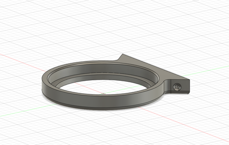

Step 2: Designing the Pencil Holder
A mug to keep pencils is probably the oldest trick in the book and I happen to have a nice mug with a motive of my hometown Lüneburg, that suffered from a broken handle. But why should it occupy desk space and risk getting kicked over? Let's mount it to the wall.
The idea is to have two identical rings, which bolt to the wall supporting the mug from the top and the bottom. Very slim in design, so that it doesn't hide the pretty motive. So fire up Fusion 360 and start designing:
  • Sketch and dimension the basic shape:
  • Inner diameter of the ring
  • outer diameter of the ring
  • diameter of the support from the bottom/top
  • Shape of the wallmount
I like having everything in one sketch, makes it easier to adjust dimensions later, the fewer sketches, the better. Also, not critical, but I recommend dimensioning sketches in a way that sets up "logical" dependencies for future adjustments. In this case for example, the ID of the ring (diameter of the mug) is dimensioned explicitly, with the OD of the ring dimensioned as the distance (wall thickness) from that.
Just a small habit to get into, really not that critical for simple parts like this as you can just quickly adjust everything, but for more complex parts it's crucial.
  • Extrude the main body
  • First the whole body without the "bottom support"
  • Then part that supports the mug from the bottom
  • Add mounting holes
  • Always neat to countersink them, fusion 360 has options for that if you use the "hole" tool
  • Add a chamfer
  • This was drilled into me in mechanical engineering classes. Anywhere a part is inserted into another part, there should be a chamfer to make it easier.
  • Add some rounding
  • just to make everything look a bit nicer, add some rounding to some of the edges
