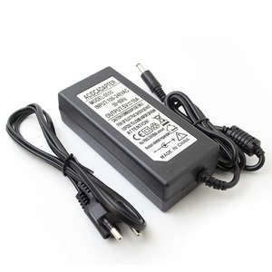

For lower powered heaters that's under 30 watts you can simply use a USB-C connection but as we go to higher power, larger tubes we will need a beefier power supply.
You can easily get 5V power supplies up to 100W as pictured above and if you need even more power I would suggest putting multiple tubes in series so that you can use more powerful higher voltage power supplies.
