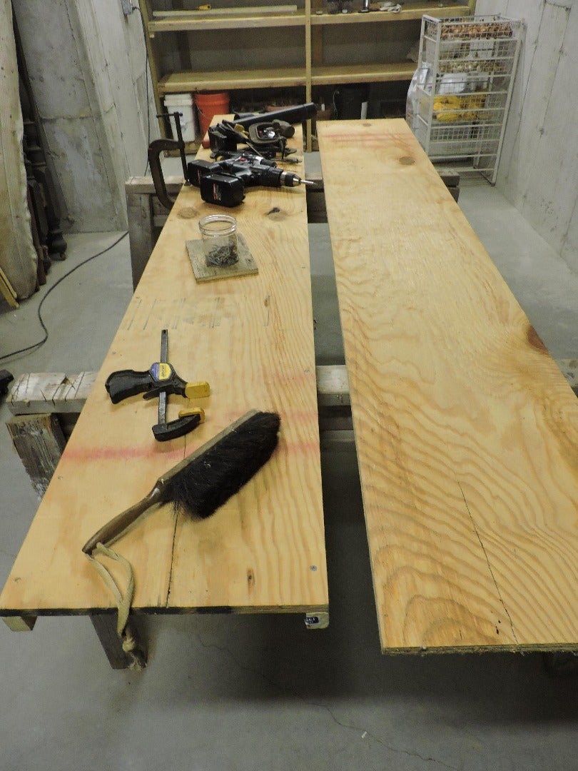

In this build I am making relatively light weight shelves. Each shelf will be 16 inches deep and 8 feet long. This is the size ( less the kerf of your saw ) you get when you rip a 4 x 8 sheet of plywood into thirds. Sometimes I go really light weight an make shelves only 12 inches deep, just rip the plywood into fourths. In this shelf setup I will have 4 shelves with a fifth which is just the floor under the unit.
Note: In ripping the plywood I have found it easiest to put the plywood on sawhorses, clamp down a straight edge and use a hand held circular saw up against the straight edge. You can make a fancy straight edge as described in: Circular Saw Rip Guide--My Versionhttps://www.instructables.com/id/Circular-Saw-Rip-... or Make Straight Cuts Every Time With A Door Board - https://www.instructables.com/id/Make-Straight-Cuts...
Step 3: The Shelves

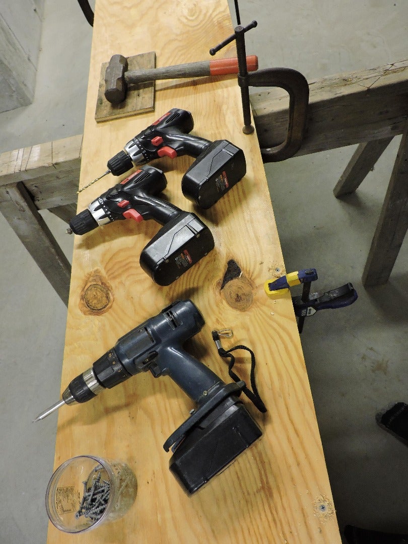

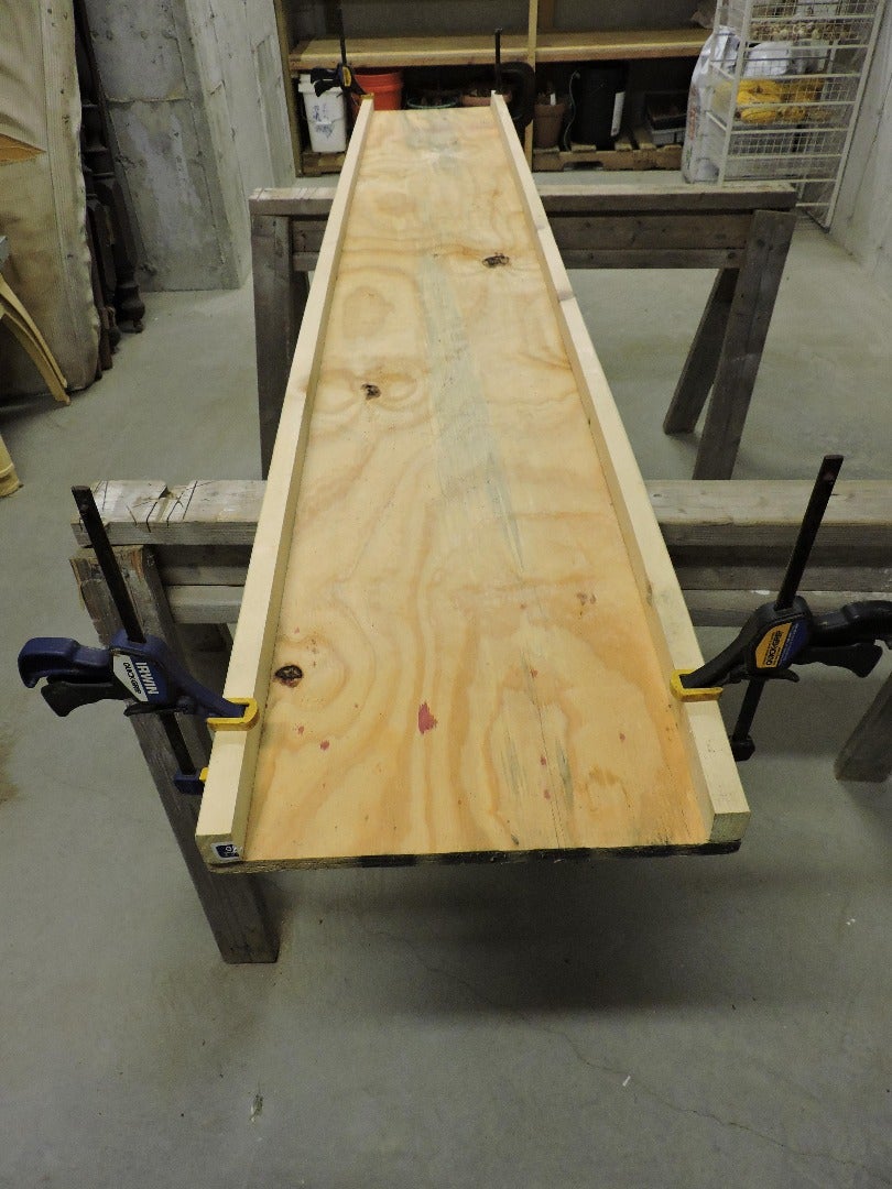

The problem with plywood is that it tends to sag under load. This is fixed by putting a rim from the 2x4 all around under the edge of the plywood. In the early days when I did this I might use a full sized 2x4 to do this. The result was a seriously over built shelf with a lot of space and expense lost to the 2 x 4. Switching to 2x3 was a bit better but still too much. I then hit on the idea of ripping the 2x4s length wise. If you rip it in half that cuts the space and cost in half. Using a table saw this is not too bad a task. For light weight shelves this is still over build in many cases and then I rip the 2x4s in thirds. This is what I will do for this set of shelves. With the plywood and 2x4 cut I lay the shelf out on sawhorses and clamp the ripped 2x4 to the bottom of the shelf. I carefully line up the 2x4 section and clamp into place. Often it is not straight so I may use a persuader ( like a hammer ) to nudge it into place. When a couple of feet are set up I use deck screws to fasten the clamped edge, then work down the shelf to the end. I generally use 5 screws for each side, perhaps few more if I had to fight the edging into place.
