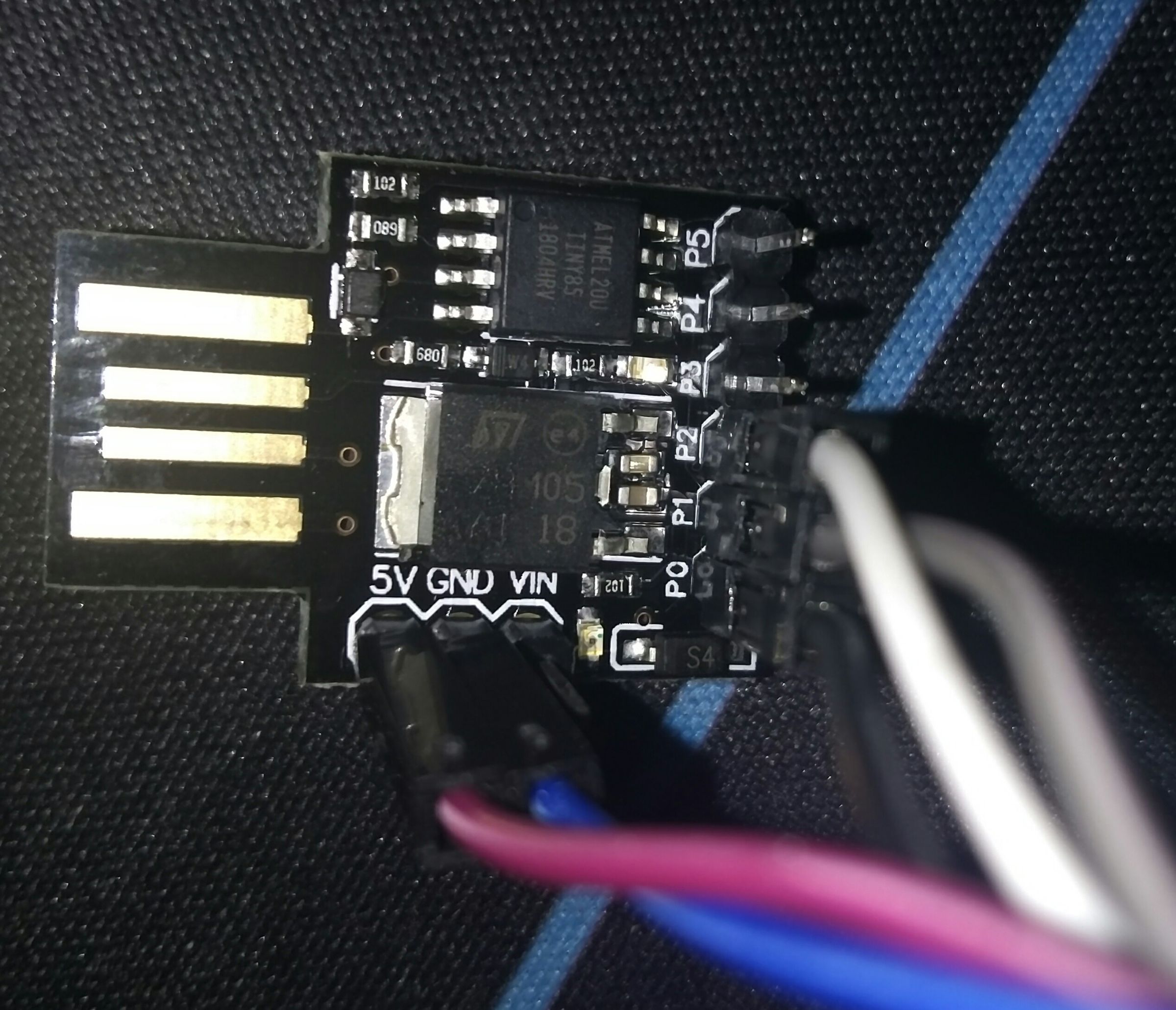

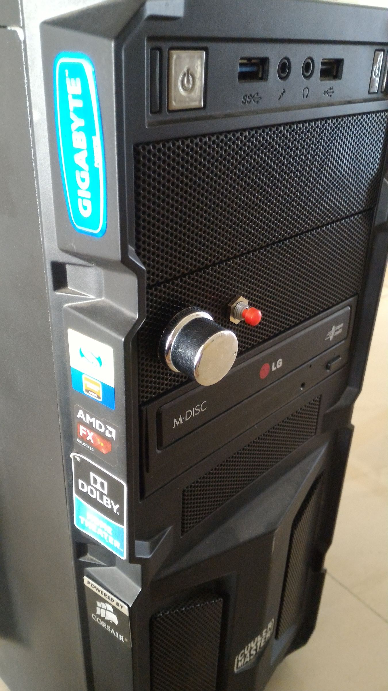

Got a desktop with a sound system far from where you sit?--I do. After a bit of digging, I found that it was pretty easy to make my own soft volume control knob on the cheap.
In this tutorial I will show you how to create a USB volume control knob for your PC!
To keep things simple, Instead of Arduino, I will use an arduino compatible board called the Digispark. Not only is the Digispark small, but it is cheap! Normally I pick mine up from aliexpress.com for less than $2 USD

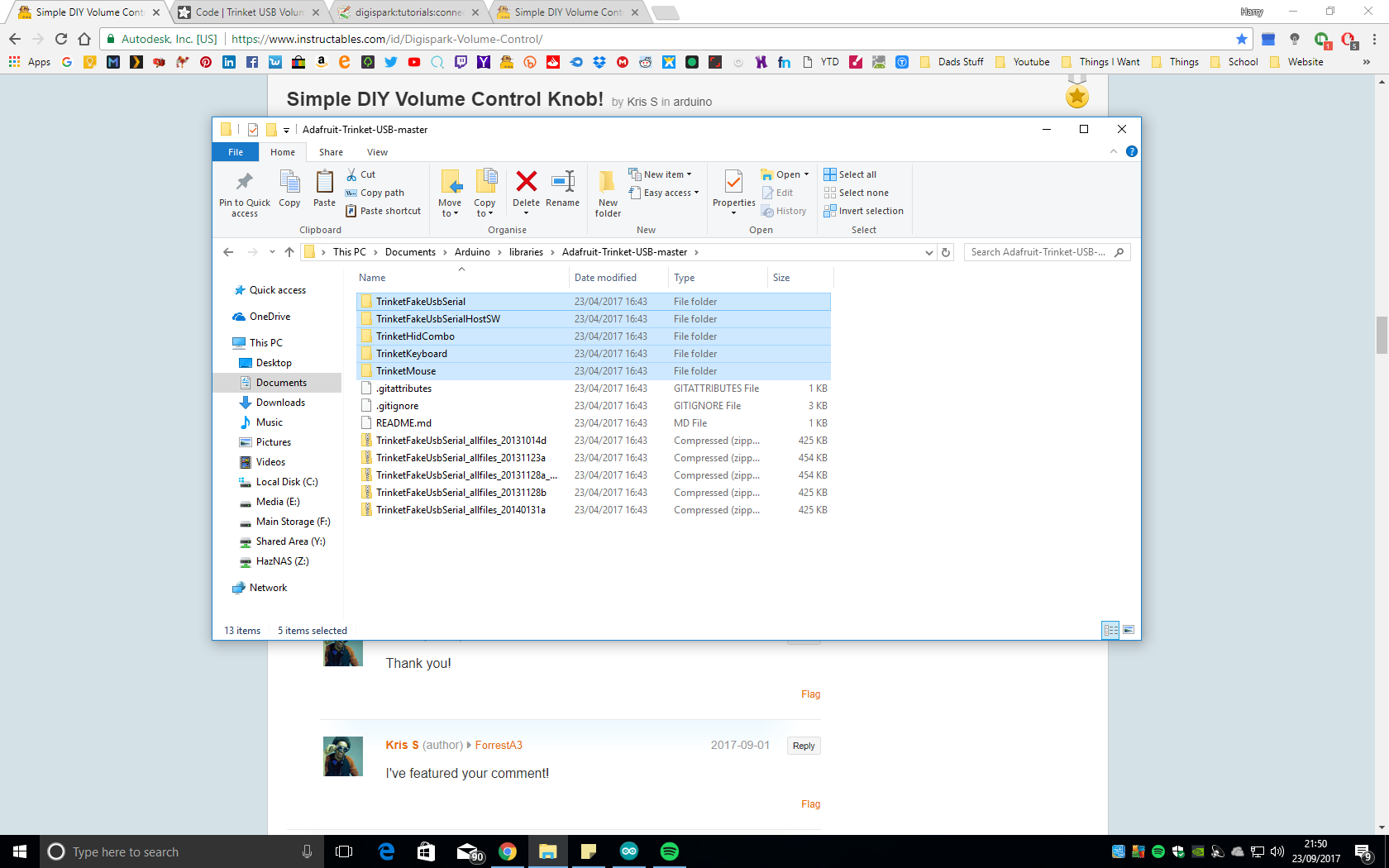

I won't teach you how to use the Arduino Development Environment, there are plenty of tutorials for that on the web already. If you are not familiar with the Digispark, setup information can be found here: https://digistump.com/wiki/digispark/tutorials/con...
Once set up, go to: https://learn.adafruit.com/trinket-usb-volume-knob... and download the Library that we will be needing for this project. Extract the .zip file and place the "Adafruit-Trinket-USB-master" folder into C:\Users\ \Documents\Arduino\libraries
Then copy and paste the sketch found on the same webpage into the Arduino IDE and upload it to your digispark.

Step 3: The Wiring
Next we can start on the hardware. I shall now demonstrate my artistic skill by drawing a simple schematic for you...
Anyway, as you can see it is very simple and that is all there is to it!
Step 4: The Build!
This is optional and depends on how you want the finished product to look (unless, of course, you just want it to sit on protoboard when you're done)
What I did was cut a small hole into a pill bottle and stick the rotary encoder though it, then I hot-glued the digispark inside the lid (remember to cut a small hole in the side of the lid for the micro USB port to connect to your computer)
Lastly I glued a piece of rubber mat to the bottom--that completes the base!
For the lid, I took the knob from an old broken stereo receiver and plopped that on top!
Note:
I also filled it with wax and iron pellets to give it a heavy quality feel, but you can watch the video to learn more about that in step 5.

Also, if you find that the rotation is reversed, try changing the following lines at the top of the sketch from:
#define PIN_ENCODER_A 0
#define PIN_ENCODER_B 2
into:
#define PIN_ENCODER_A 2
#define PIN_ENCODER_B 0

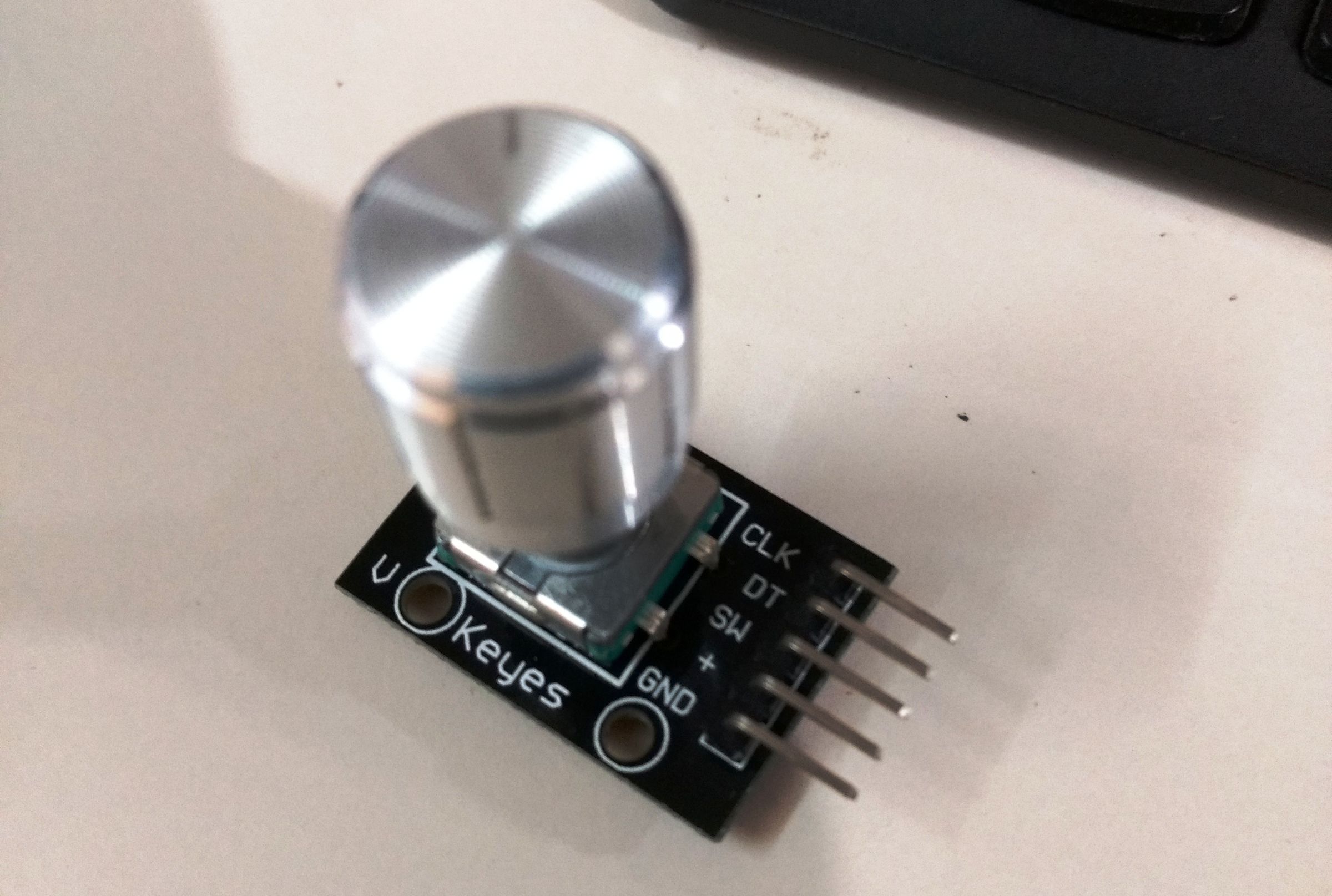

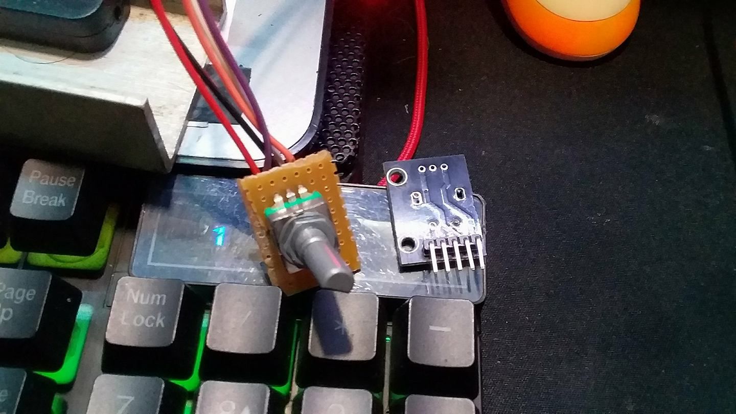

mauempoleon
mauempoleon
Question 2 years ago
Hi, i´m making the project but the mute button doesnt work, it only turn off the intregated LED on the Digispark. What can i do?
0
scek.uros
scek.uros
Answer 2 years ago
If I connect cables like this then volume control is very smooth. With other configuration it doesn't work as well. Sometimes it doesn't change volume, sumetimes do.
I'm using rotary encoder with small motherboard underneath and it has 5 pins, so I can't copy from original post (which has only 3). I'm also using ATTINY85 with microUSB, not the one from the picture.
I really would like MUTE to work so I could finish my project. The red light near the P2 pin blinks if I press the switch so I must be very close. None of the solutions in comments doesn't work for me. Or I don't understand how to connect cables :)
So if anyone has the solution, please share.
0

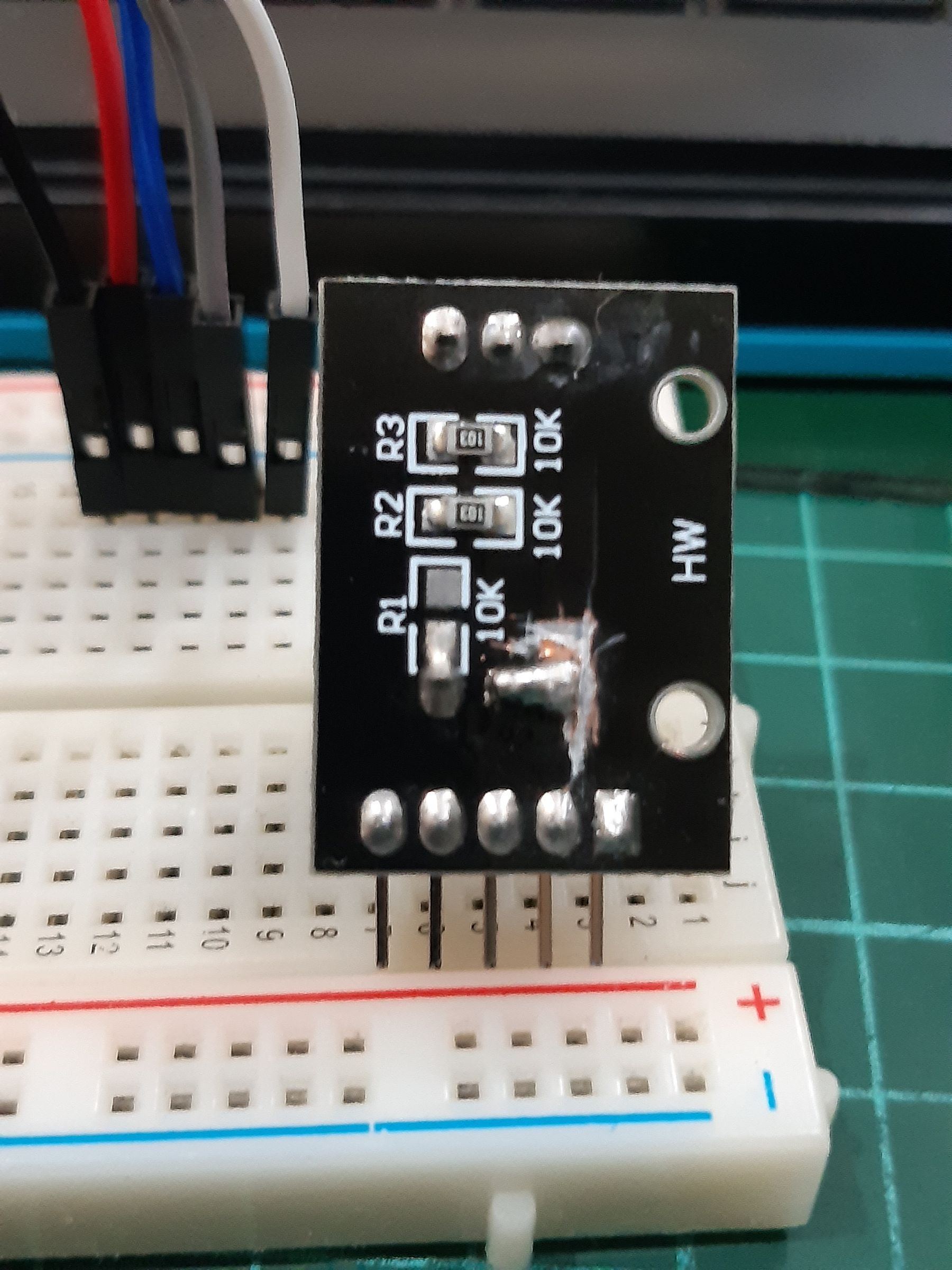

kroome
kroome
Reply 1 year ago
if you are using encoder with built-in resistors, one pin of the switch
is connected to ground therefore you need to transfer the connection to
(+) ... just traced the pins of the button switch to make it sure...

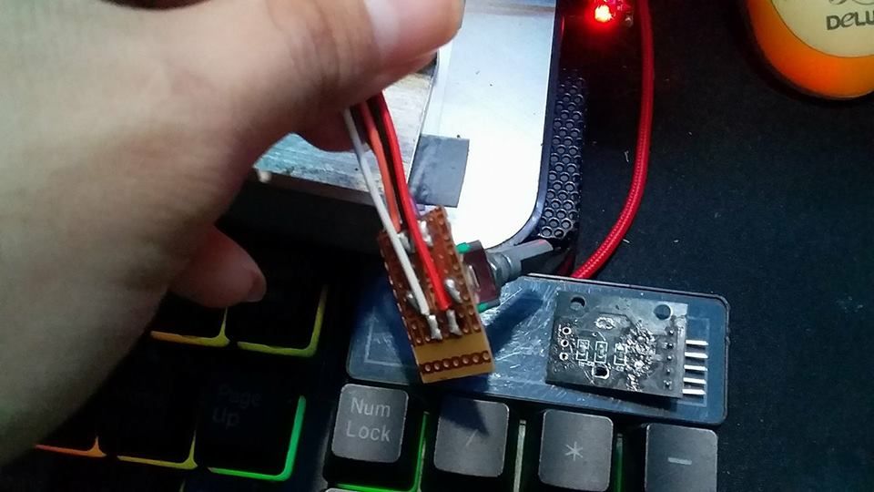

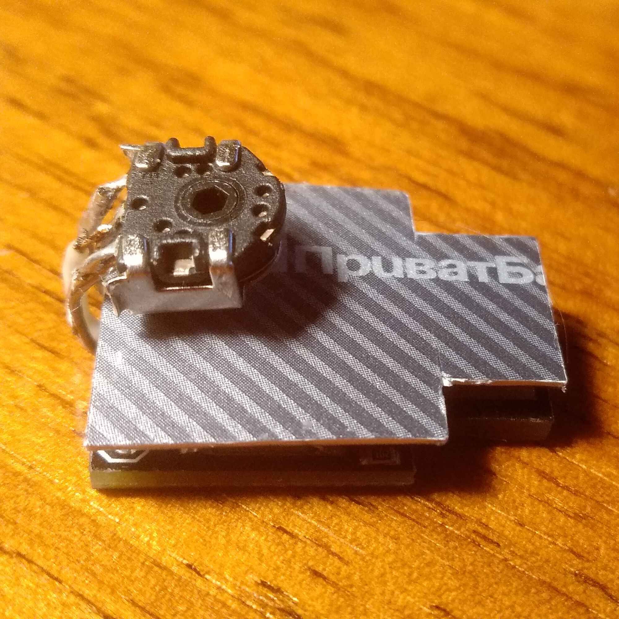

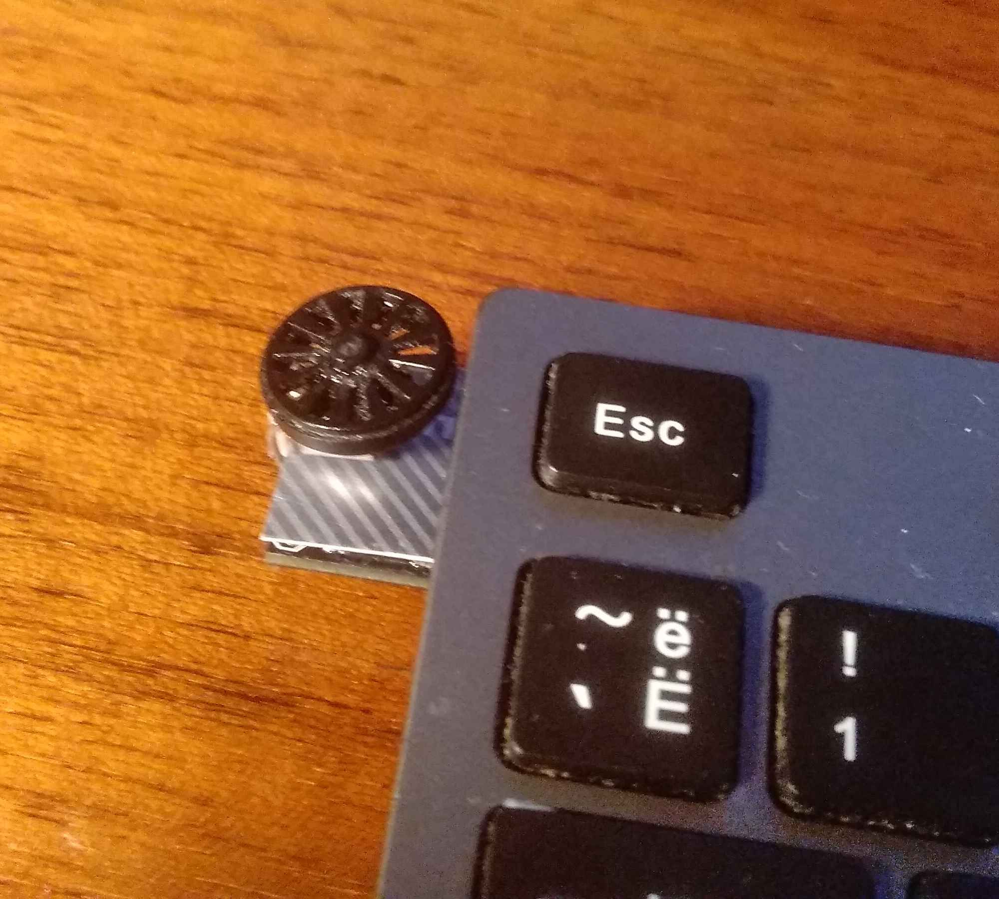

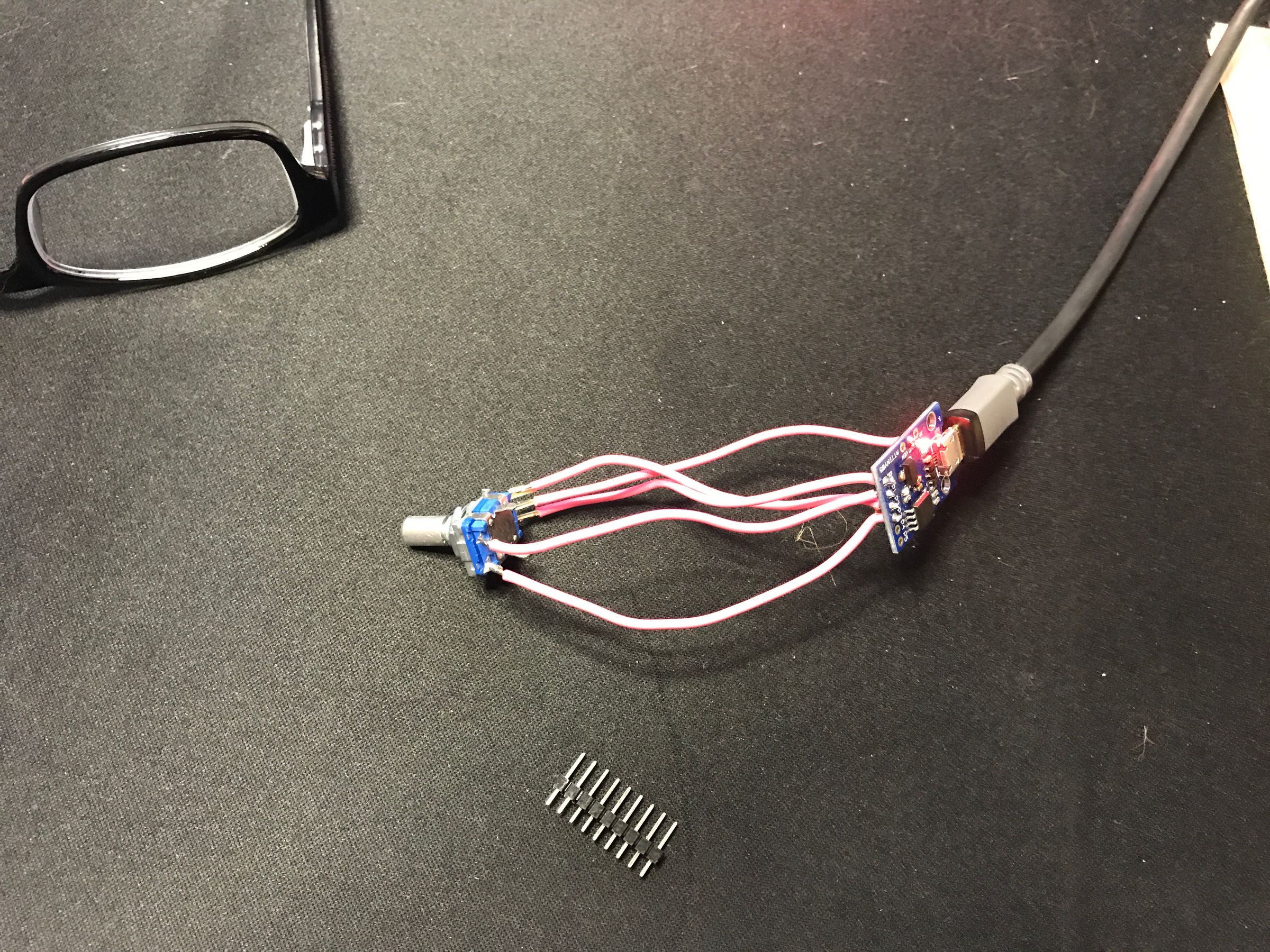

psychodido
psychodido
3 years ago
Hey Kris, Please help! I make it work only with volume knob!!! But I can not do mute when i pres the knob... The photos show how I've connected Rotary encoder and The ATtiny85! Where am I wrong?
0
BastianM7
BastianM7
Reply 3 years ago
Hey psychodido. Did you get it to work? I wired my Tiny85 with the encoder as shown in your pictures; my volume up/down now works correctly, but i have the same problem as you: The Mute-Button don't work. Any suggestions? :-/
0
kroome
kroome
Reply 1 year ago
0
Quang1102
Quang1102
Reply 2 years ago
Hey psychodido.
Tôi cũng có cùng một vấn đề như bạn, và tôi giải quyết nó bằng cách loại bỏ các
bảng mạch và chỉ để lại bộ mã hóa quay sau đó nút tắt tiếng đã hoạt
động đúng cách. Tôi nghĩ rằng các điện trở trong bảng mạch đã gây ra
vấn đề này
