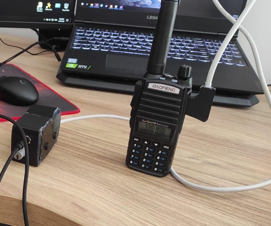

Introduction: Digital Night Vision Goggles
This project demonstrates that with a low budget, you can make a monocular or binocular pair of digital NVGs. This pair is based on the BPNVG project. It uses an Foxeer Micro Night Cat 3 IR sensible camera and an Adafruit NTSC/PAL 2" display. This pair can be used on helmet mounts with a Wilcox L4G24 mount.

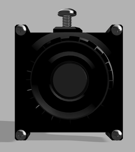

Step 1: Mechanical Model
I made this model in Fusion 360, and the models are either made by me(Adafruit Display, Eyeguard), McMaster-Carr components, or from GrabCAD. The Eyeguard has been posted on GrabCAD. The model itself is 3D printed.
The goggles can be mounted on a standard NVG mounting plate with a Wilcox L4G24 mount.

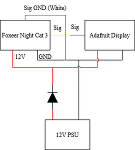

Step 2: Electrical Scheme
This scheme is very simple. I added a 14N001 Diode for reverse voltage protection. Signal from the display is a yellow wire, and the wire for the camera is white. Be aware not to connect white to white, as it won't work.
The working current is 315mAh for 12V, so a boost converter with an 2200mAh 18650 battery would last you approximately 2 hours.
