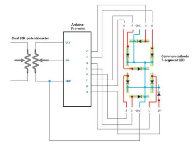

Step 1: Schematics
The schematic of the digitized audio analog volume (from hereinafter as DAV) is not complicated.
The whole circuit consists of only three components with Arduino pro-mini, a dual gang 20K potentiometer, and a common cathode 7-segment display.
The potentiometer should be a dual gang type (physically identical two variable resistance units are packaged as a single potentiometer) for supporting digital volume level display and acting as an analog audio level attenuator at the same time.
The individual variable resistance (VR) unit inside a dual gang type potentiometer is physically isolated.
Otherwise, digital noise produced by one VR unit is infiltrating into the analog audio VR unit side.

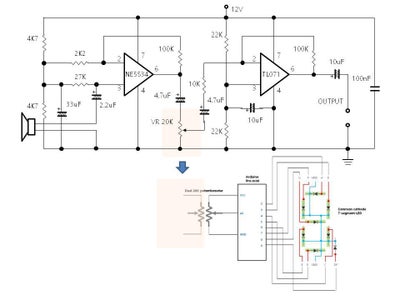

When you look at the other schematics, the DAV is connected to the pre-amplifier of the Sound Level Meter circuit.
The analog side VR unit of dual gang potentiometer replacing 20K volume control VR part of pre-amplifier.

For minimizing size of the DAV circuit, the 7-segment display and Arduino pro-mini mounted on the small size of universal PCB with male pin-header and female pin-header socket.
Also pin-header and DuPont wires are used for connecting Arduino and 7-segment display.
The following parts are used for making the DAV circuit.
-         Arduino pro-mini 5V 16MHz
-         Common cathode 7-segment display (Green color)
-         Dual gang 20K potentiometer
-         Pin-header (male and female sockets and terminals)
-         Universal PCB, DuPont wires
-         LM7805, 0.33uF film capacitor and 0.1uF ceramic capacitor

As the DAV is the unitary function of the break-out circuit, it can be included in another circuit as a part.
Therefore, it is integrated into the Sound Level Meter (SLM) circuit to control the input sound level.
Please look at the details of the SLM circuit in the Instructable below.
https://www.instructables.com/Sound-Level-Meter-With-3-Color-LED-8x8-Matrix/
The two VR units included in the dual gang potentiometer are divided to be assigned to the DAV circuit and another is integrated into the pre-amplifier circuit of SLM.
As the two VR units are completely isolated, no digital noise created by the DAV circuit is interfering with the pre-amplifier circuit.
The DAV can control the input sound level and show the VR resistance level at the same time.

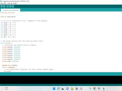

Step 4: Sketch Program

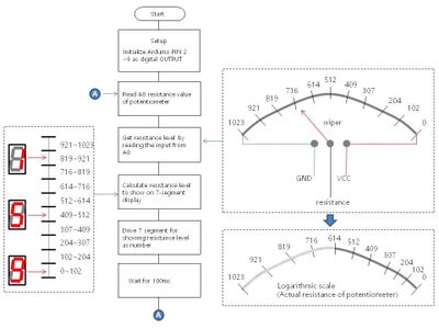

When the program is started, digital PIN 2 to 9 of Arduino is configured as the output port.
PIN 2 is wired to A part of the LED of the 7-segment and the PIN 9 is mapped to DP LED of the 7-segment display.
Then resistance is read from the A0 analog port as shown in the flowchart picture above.
The Analogread(A0) command reads current resistance between 0 to 1024.
For mapping resistance value to 0~9 of 7-segment volume levels, I divided each level as 102.4 as shown on the left side of the flow-chart picture.
But actually, the resistance strip (where the wiper is contacted) of the potentiometer is made as a logarithmic scale as shown on the right bottom side of the flow-chart picture.
Initially, the resistance value slowly changed and rapidly decreased from the 2/3 portion of the resistance strip.
This logarithmic resistance strip making is a kind of safety measure to protect against the possible hazard.
Let’s assume a potentiometer is used in a power amplifier.
When if the resistance level is decreased very rapidly at the initial stage (Initially turning the volume clockwise), a very loud output sound can be produced to hurt your eardrum.
Therefore, the actual potentiometer decreases resistance slowly at about 2/3 of the turning position and rapid changes in the remained 1/3 volume position.
Anyway, the read resistance value is mapped to the present volume level and displayed on the 7-segment display.

The sketch program repeats the reading of the A0 analog port to get resistance value, mapping present resistance to volume level, and displaying volume level of 7-segment continually.
