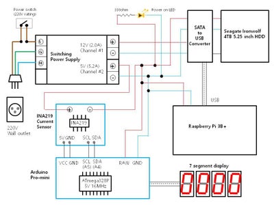

As file server circuitry details are explained in another Instructable, I’ll focus on the INA219 current meter circuit in this story.
For your better understanding, the file server circuit consists of the following components.
-    High capacity (5V/5.2A, 12V/2.0A) two-channel switching power supply unit providing electricity for operating RPI and 5.25-inch HDD
-    5.25 inch HDD interfaced with RPI via SATA to the USB interface module
-    As 5.25 inch HDD requires 12V power for operating the platter motor and 5V to activate the HDD controller board, two different voltages of power supplies are required
-    RPI 3B+ installed with Linux operating system and support Samba file system service to connect with PC
-    Using the Windows explorer program, the 4TB HDD can be accessed via network-connected storage with the directory link such as “\\192.168.0.3\pi”

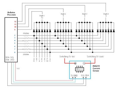

Although 16x2 LCD is used with the INA219 current meter in the circuit above, this time 4 digits 7-segment display is used in this project.
But the operational scheme of the current meter circuit is the same.
When the INA219 sensor is embedded in the plus(+) terminal of the power supply, the current flowing in the hotline (plus terminal) is sensed, and captured data is transferred via I2C communication lines to Arduino pro-mini board.
As I’m only interested in the current value, the presently flowing current level is displayed as mA (0000mA ~ 9999mA/9.9A) on the 4-digit 7-segment display.
As a common anode type of 7-segment module is used, the sketch program stored in the Arduino processing sensed data from INA219 to show mA values correctly on the 7-segment display.
I’ll explain the operational logic of the sketch program in the other step below.

When you look at step 1 – schematics, the 7-segment connected to the Arduino with 4 control lines (Arduino pin 9 ~ pin 12) and 7 data lines (Arduino pin 2 ~ pin 8).

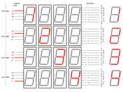

As the 7 data lines are shared among 4 digits of 7-segment modules, each digit should be shown serially very short period (such as 5ms ~ 10ms).
When brief and sequential number showing continuously executed, the 4 digits number seems steadily shown on the 7-segment display as the explained picture above.
It’s a kind of visual trick that is widely utilized for showing a movie with a very long film consisting of many picture frames.

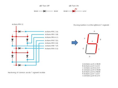

When you look at the picture in the middle, you can understand how the common-anode type 7-segment display is working.
For correctly displaying the number, the voltage state of 7 data lines should be correctly configured as shown sketch code below.

For example, the number 4 is displayed on the 7-segment by setting each data line voltage like above.
Also for displaying the number 4 in the rightmost position, the following sketch code should be executed.
void ON_1th() {
digitalWrite(D1, LOW);
digitalWrite(D2, LOW);
digitalWrite(D3, LOW);
digitalWrite(D4, HIGH);
Among the 4 control lines, only the D4 (Arduino PIN 9) voltage level becomes HIGH (5V) for enabling the rightmost position of the 7-segment.

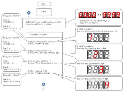

When assuming the presently flowing current level is 1234mA, the leftmost digit (Decimal 1000 value) is calculated using the modulo (%) operator like below.
-    Firstly current value (1234mA) divided with 1000
-    Then temporal value from the division operation becomes 1
-    Then get the remainder by module (1%10) mathematical operation
-    Finally, you can get the decimal 1000th position value 1
If you look at the modulo operator’s calculation scheme, you can understand how each digit number can be calculated,
For more details, please look at the sketch program attached to this step.
When you compare the sketch code with the flowchart above, maybe you can easily understand the overall current value displayed on the 4-digit 7-segment display.

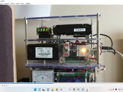

As the displayed current level is measured only by the 5V power supply line, the displayed value does not show all current flowing from the switch power supply module.
But all the main power-consuming circuitry is connected to a 5V power line (12V power is used only for activating the HDD platter motor), displayed current value can be deemed as a major power consumption result of the file server circuit.
As you can see in the video below, maximum power consumption reached about up to 1200mA (1.2A) while RPI booted and initialized HDD for connection.
https://drive.google.com/file/d/15iSnui1-gm5cXvDRFFYbaRaJRNiNXHdJ/view?usp=sharing
When heavy storage accessing command (such as running scp –r command from other RPI server) is used, I can about 1.8A of current flow sometimes.
But total current usage by RPI and HDD is not over the 2.0A level.
Finally, I can see how much current is consumed by RPI with a heavily over-loaded situation.
