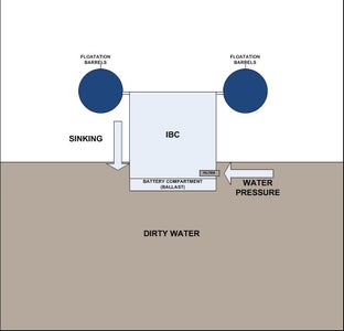

The idea is based around an IBC (Intermediate Bulk Container), these are common on farms and in chemical plants all over the world.
This IBS would have the bottom valve removed and replaced with a micro filter to remove dirt and microbes from the water.

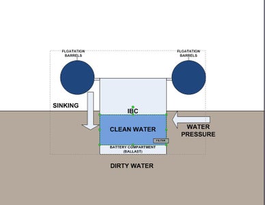

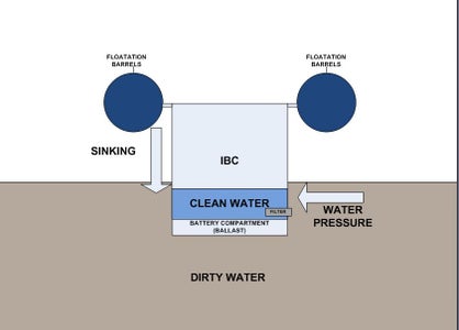

The IBC would start to fill and sink, sinking would continue until the 4 sealed plastic 55 gallon drums hit the water level, these become the raft keeping things afloat.
My theory is (and please correct me if this is wrong) that the tank, once full would become neutrally buoyant, the weight of the additional equipment on board, including the tank itself would make it want to sink but the sealed containers make it remain afloat.

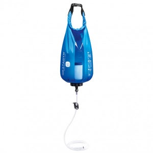

Filter: €98 www.alpinetrek.co.uk

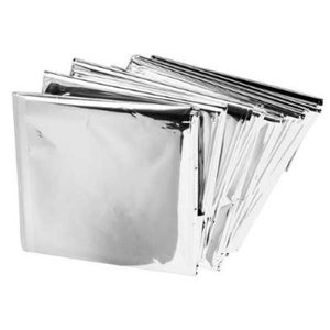

Mylar blankets: https: €8 www.amazon.com/Emergency-Mylar-Blankets-84-52/dp/B01M12OVJW?th=1&psc=1

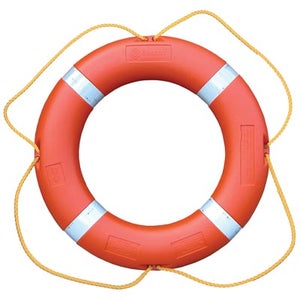

Bouy: €47 https://ie.glasdon.com/water-safety/lifebuoys

Step 3: Flotation Concept
This is where my understanding of the mechanics may be wrong but here goes:
The IBC is ballasted by the 2 batteries mounted near the bottom in water tight containers. I have used these batteries before and they are approx 25kg each so this 50kg pulls down on the IBC and keeps it right side up.
This causes the IBC to try to sink, water is allowed into the IBC via the space where the lower valve was but is has to pass through the filter, purifying in the process.
The filter allows 2 litres of water per minute to be filtered, an IBC holds 1000l but say take out 100l capacity for battery storage. This means that the unit would take 7.5hrs to fill completely.

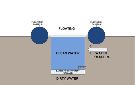

The IBC fills until the barrels get to the water line and create buoyancy, you now have a raft with 900l of clean water underneath.
The 55 gallon barrels convert to approx. 215l each, there are 4 barrels so that is 860l of displacement, if my maths are correct that is 860kg capacity before the rig sinks.
Say the batteries weigh 50kg and the IBC and other equipment another 50kg, this leaves 760kg of flotation for people. Say the average person is around 80kg this means 9 people could technically be on board, now this is like the capacity plate in the elevator that says the box the size of a small fitting room has a capacity of 21 people, it may do it but you would never get 9 people on top of one of these things.
There is also an outer hand rail for people to pull themselves aboard.

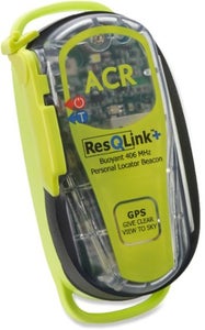

The personal locator beacon (PLB) is key here, t the push of a button, rescuers will know your location.
The filter I have shown is only an example it is for camping and is slow and needs modification, I'm sure there is a better one out there. The idea is correct however, water pressure alone drives the water through a microfilter that removes particles and tiny bacteria.
The filter will not remove lepto sporidium as it is smaller than a water molecule and will pass straight through the filter. The UV pen will kill this off however.
