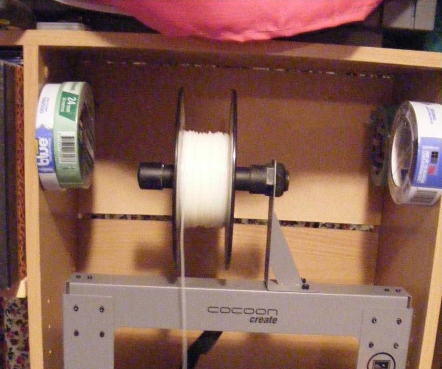

I decided to modify something I saw on Thingiverse with an IKEA Lack Table as a 3D case to hold the heat in and dust out. I did the original and it worked well, but I had a desk where one of my 3D printers are, so I decided to modify the original so I can use the new one in almost any situation and size. The desk area is actually where you can put an original printer, so it had small sides and a back already, so I thought I could use that to my advantage.

I made a wooden top section by using 18mmx18mm wood. This will determine the full size front to back, and side to side. In the photo you can see how big the area needs to be. I screwed the wood together to make the U shape and attached brackets. These were later removed and flattened down as they were better to put on the inside of the shelving. You can see the area already there so I matched the outside of the wood to the area to sit flush. I also marked the front corners as this is where the bottom hinge section will go.
