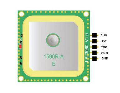

The 1X5 right angle pin is soldered to the LS20031 GPS receiver. To solder them together, there is an easy trick that makes it very simple. Solder the pins to the GPS receiver. The completed soldered GPS receiver should look like the image above.
For an introduction to the LS20031 GPS Receiver, check out this tutorial, or instructable, from Jaycon Systems.

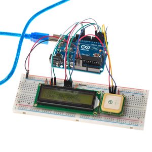

Step 5: Hardware Assembly - Arduino
The Arduino Uno board has a built-in voltage regulator, which can supply both the 5V and 3.3V. We can directly connect the pins from the board. The GPS receiver LS20031 will operate in 3.3V. For the LCD, the voltage connected is from the 5V pin. For this project, the wires on the board connected are 5V, 3.3V, GND, and the data lines are 12, 11, 5, 4, 3, 2, 1, 0.
Step 6: Hardware Assembly - Bread Board Assembly
The LCD and GPS receiver are inserted to the bread board. The connection should look like the diagram above.

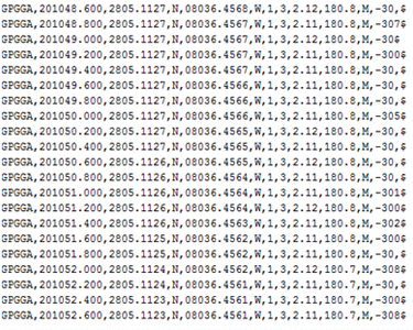

When the code uploads, the GPS takes time to lock onto our position, so we need to be patient. Once the GPS is stable, the red light in the GPS will start to blink. The image above is the output given by the GPS receiver before doing any operations with the received result.

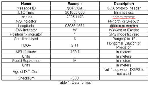

Let’s analyze one of the lines to see what each thing means:
$GPGGA,201052.600,2805.1123,N,08036.4561,W,1,3,2.11,180.7,M,-308
The chart above breaks down each value so we know what we are looking at.

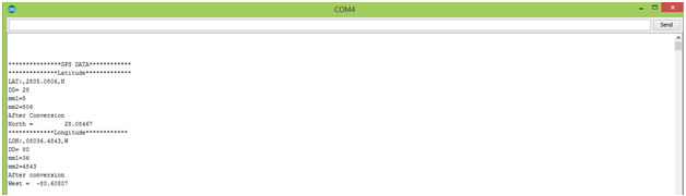

Step 16: Results - Conversion
The picture above shows the result after the conversion has taken place in the code.

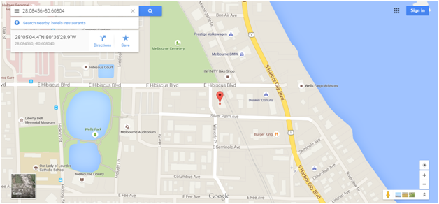

The values can be directly used in Google maps to find the location.
28”08’462’N; 80”60’798’W is the location of 801 E Hibiscus Blvd, Melbourne, FL 32901, which is the address of Jaycon Systems!
