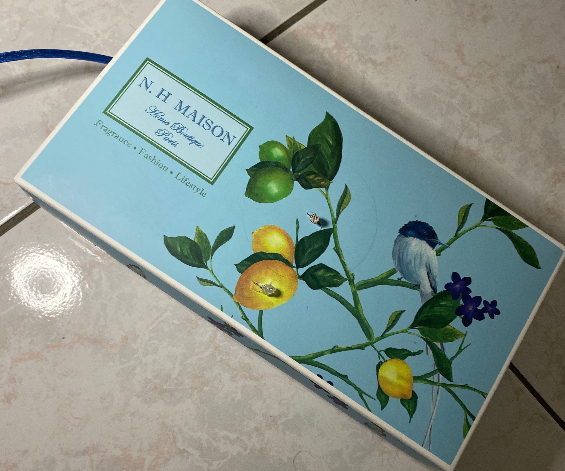

Step 1: (Optional) a Box/case for Your Distance Sensor
(This isn't needed.)
I found a small paper box in my house, so I decided to use that to hide the circuits. Two holes are cut at the top of the box, so the LED Ring and the ultrasonic sensor can get out. Make sure to cut a hole to let the power cable pass.
