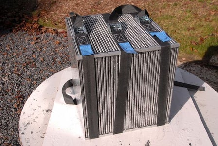

The air to air heat exchanger is made of aluminium plates assembled with special glue.
It has a measured efficiency of 65% : with an outside temperature of 10°C, renewed air is heated at 16-17°C by inside air rejected at 20°C.

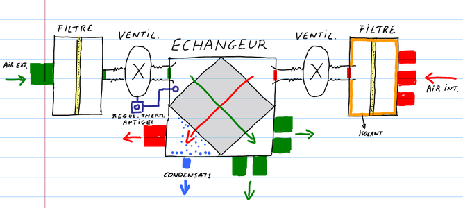

Step 1: How It Works
The hot fouled air from inside the house is extracted outside through the exchanger.
The cold clean air from outside is injected inside the house through the exchanger.
Both flows are not mixed together, they just transfer their heat through aluminum plates.
Because the hot fouled air is most of time humid, it condenses at the contact of cold plates. So a condensate evacuation must be planned.
Air is extracted and injected by two fans.To prevent the fans and the exchanger getting dirty, I add two filters on both side.
Finally a temperature regulator is used to control fan speed to avoid frozen condensats in the exchanger in the winter.
Step 2: Heat Exchanger

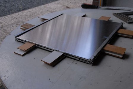

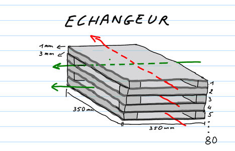

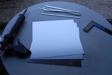

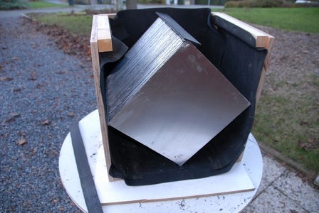

There are two main types of air to air heat exchanger in ventilation units : crossflow and counterflow. Counterflow exchanger are more efficient but not easy to do it yourself. To keep it simple, I built a crossflow model. Hot floued air goes between one plate out of two and the clean fresh air that goes perpendicularly the other plate out of two is heated.

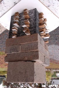

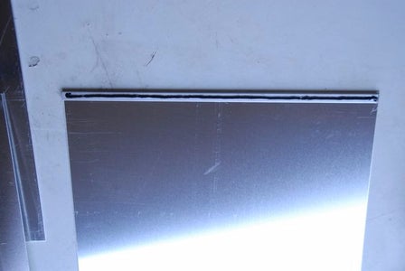

The exchanger is built from 80 aluminium plates of 350x350 mm. So it has 10 m2 exchange surface. There is a space of 3 mm between each plate (two aluminium strips of 3 mm are glued between two plates with alternate axes)
Plates are glued with polymer glue (Tec7) ant put under pressure during 24h.

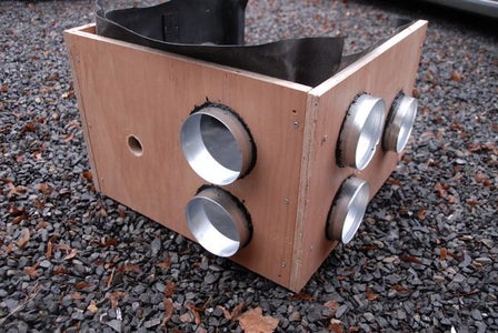

Step 3: Exchanger Box

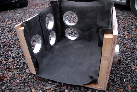

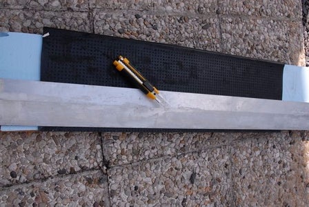

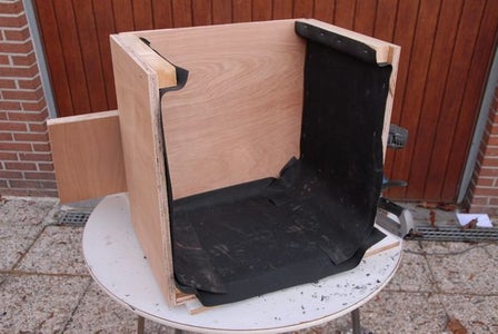

The exchanger is place in wooden box.
The box is sealed and waterproof thanks to a rubber tarpaulin and rubber bands.
There are several openings provided for input and output flow ducts.

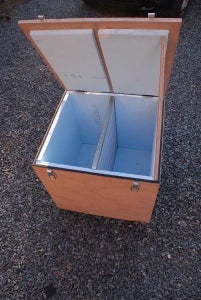

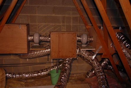

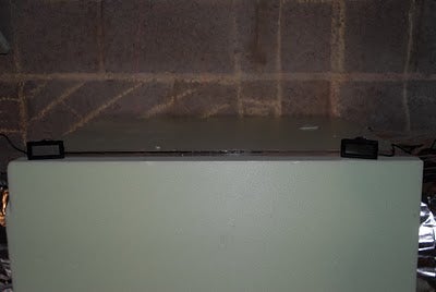

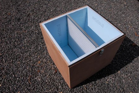

Step 4: Filter Boxes

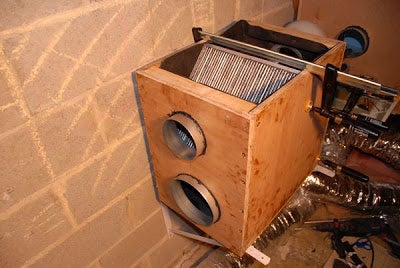

Two boxes made of wood with isolation inside contains the filters (50cmx50cm).
Big filters have many advantages : lower pressure drops and fewer maintenance.
One of the filter also has a role of flow dispatcher (see Pipe network step)
Step 5: Fans and Ducts

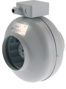

I used two duct fans of 45 W which have a theoretical flows of 260 m3/h at a pressure of 0 pa.
You have to be sure that they deliver enough rate of flow for your estimated pressure drop (see next step)
The fans are inserted between the filters and the exchanger.

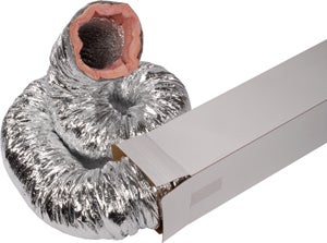

All pipes are flex isolated ducts. Condensate were going in a bucket at first but it is not linked to wastewater evacuation.

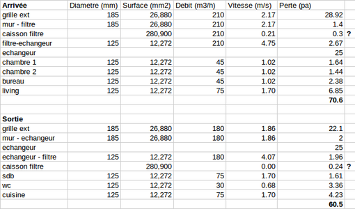

For a complete study, you should also calculate the pressure drops of your installation including the pipes, filters ..
Keep air speeds under 3 m/s to avoid noise.

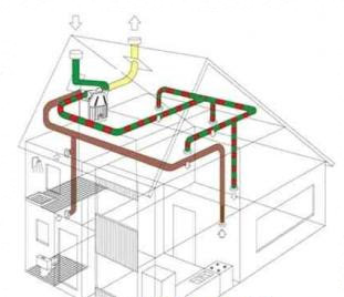

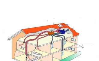

You also have to choose a pipe network.
You have the choice between several topologies :
  • A/ traditional distributed network with T connection (A+ first image)
  • B/ star network with dispatch boxes (B+second image)
  • C/ network with forks. (C + third image) The flow is naturally split like a "reversed" river stream. Pressure drops are optimized.
The choice of the pipe network is very important to avoid noise and pressure drops.
The best network for me is the C one in the diagram. (It is the one I set up in my second VCM installation.)
In this first installation I went for a star network (B) with big dispatch boxes that also have a filter role (see previous step)
The (A) network is the most common, the simplest and cheapest to install but results in noise nuisance. That is very annoying for a ventilation system running days and nights !

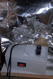

1/ Anti-frost system :

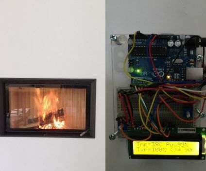

To prevent the condensates from freezing inside the exchanger in the winter you have to add a fan speed regulator controlled by temperature. That way you decrease injected flow rate and get a different energy balance. I bought it already built but you could easily build one yourself with an arduino. Have a look at my Arduino Wood stove regulator project, it should be similar.

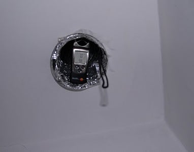

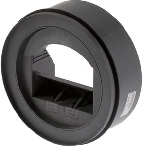

To balance the flows, you can use rate flow regulators inside the ducts as the one in the picture.
Flows rate can be measured with an anemometer.
