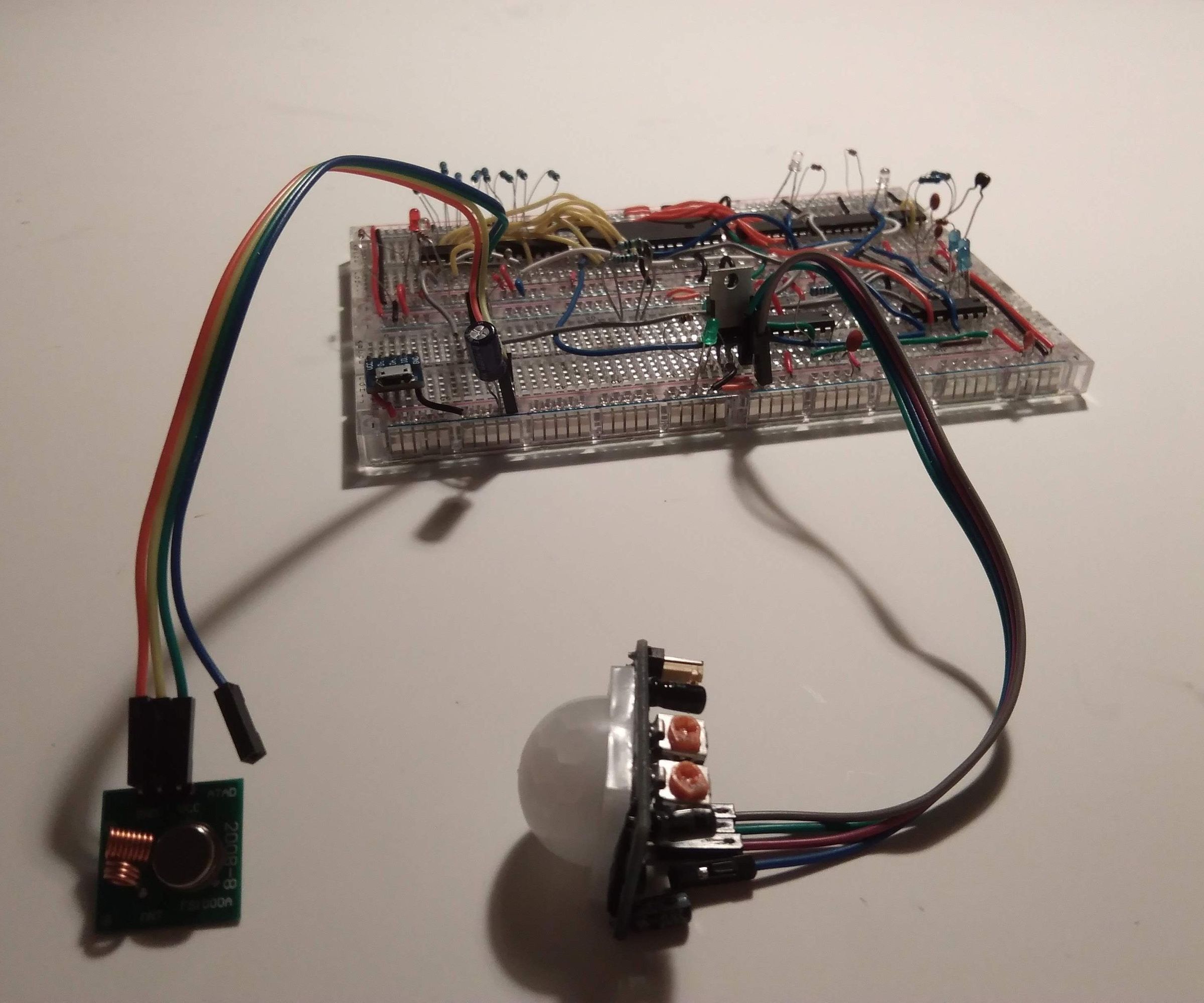

In this Instructable, I will drive a 28-BYJ-48 step motor, with a UNL2003 darlington array board, sometimes named x113647, without a micro controller.
It will have start/stop, forward/backward, and speed control.

To generate the 1100 shifted, repeated pattern from the 74HC595, pin 14 (SER) should be kept high for two clock cycles, and then low for two clock cycles repeatedly. That is, the pin should oscillate with half the frequency of the clock.

Step 3: Make It Run
We now can make the motor run, If Pins 0-3 of the 74HC595 are connected to the Pins 1-4 of the ULN2003 board respectively.
For now, replace the 0.1µF capacitor at Pin 6 of the 555 timer with a 10µF. This will make the clock cycle hundred times longer, and one will be able to see what is going on.
The LEDs on the ULN2003 boards can be used for this. Unplug the motor from the ULN2003 board. Connect Pins 1 to 4 of the board to the output QA-QD (pins 7, 9, 10 and 11) of the 74HC595. Connect the - and + of the ULN2003 board to the ground and 5V. If the power is turned on, you should see the wanted pattern on the LEDs.
If you want to see what's going on in the 74HC393 binary counter, connect to pins 3-6 of that one in stead.
If the pattern seems right, power down, replace the capacitor with the 0.1µF again, connect input pins 1 - 4 of the ULN2003 board to the output pins QA - QD of the 74HC595, and plug in the motor again.
With the power on, the motor should now run.
