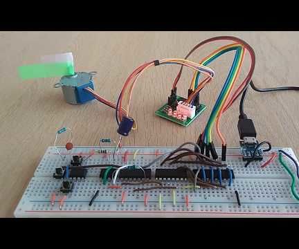

Introduction: PIR Controlled 433MHz Switch Without a Micro Controller
A PIR motion detector sensor is used to trigger sending off or on commands to a 433MHz switch. This is quite easily done using a micro controller, but this project will not use a micro controller (other than for some initial steps).
Hence this project should be a strong candidate for the Most Useless Project Contest, if such a contest existed.
The idea is to store the codes for turning the switch on and off in an EEPROM, The PIR sensor should trigger transmitting the code to the switch via a 433MHz transmitter.
