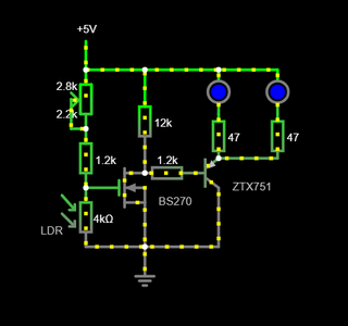

Auto LED Board
BS270 NFET
ZTX751 PNP
LDR (Light Dependent Resistor)

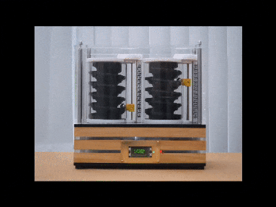

Step 1: Description

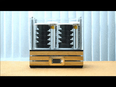

Two separate and identical elements are used which consist of a stepper motor driven spiral, magnetic vertical slider and steel ball bearing. The ball is attracted to the magnet on the slider and the pair are lifted by the spiral as it rotates with the time indicated by its position and markings on a vertical scale.
When the ball/slider combination reaches the top of its travel the ball is knocked off the slider by the spiral.
The slider falls to the bottom and the ball rolls down the spiral to be met at the bottom by the slider were the process repeats.
During the course of the build, elements were printed in a varieties of colours, in some cases this is due to the availability of materials and/or trials to assess the look. Feel free to colour co-ordinate as feels fit.
The reference start (home), position for the spiral and the slider are verified by hall sensors and magnets.
All this is controlled by a Raspberry Pi Pico with RTC and LCD used for both time setting and display.
The specific LCD display was chosen due to its small size and integrated push buttons negating the requirement for separate buttons.
The LCD displays the time in 24 hour mode whilst the Spirals display the time in 12 hour mode.
All this housed in an acrylic and wooden case.
Size: 215(H) x 218(L) x 118(D) mm
Weight: 2.12kg
Supply current at 5V (static typ. 42mA), (active typ. 260mA).

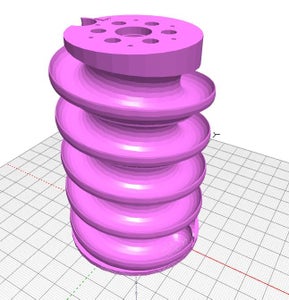

The 3D printed elements were designed using BlocksCAD, sliced using Cura 4.5.0 and printed on a Labists ET4.
3D Printed elements required.

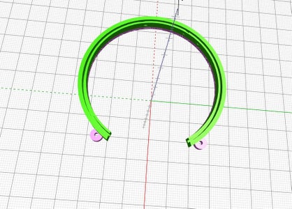

Vertical Helical Spiral - 100 (H) x 66 (dia) mm, 196g - 2 required.
The spirals are by far the largest items to be printed and therefore consume the greatest amount of printing time.
It's also recommended to print them individual to minimise time, strings, blobs or other abberrations which may develop travelling between multiple models.
The track in the spiral is designed to accommodate a 10mm steel ball bearing.

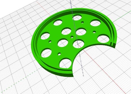

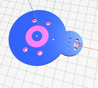

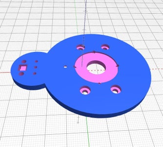

Top plate: 84(W) x 66(D) x 4(H) mm, 18g - 2 required.
Base plate: 84(W) x 66(D) x 4(H) mm, 17g - 2 required.

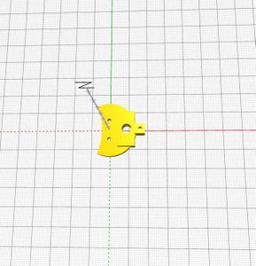

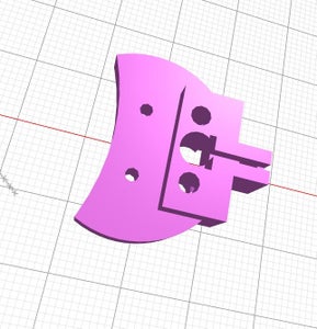

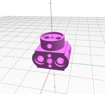

Top: 46(W) x 40(D) x 10(H) mm, 11g - 2 required.
Top crescent: 24.9(W) x 28(D) x 7(H) mm, 3g - 2 required.
Base crescent: 24.9(W) x 28(D) x 7(H) mm, 3g - 2 required.

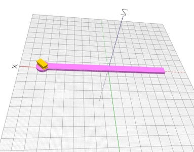

Slider: 13(W) x 18(D) x 15(H) mm, 3g - 2 required.
The top and base are almost identical with the exception of the centre holes, the top fixes to a spindle bearing whilst the base allows the axle of the stepper motor to protude.
Between the top and the base run the rails on which the slider travels.

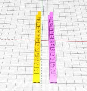

Time bars: 8(W) x 115(D) x 5(H) mm, 5g - 2 required.

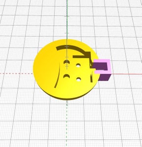

RTC cover: 32(W) x 22(D) x 7(H) mm, 3g - Three parts.

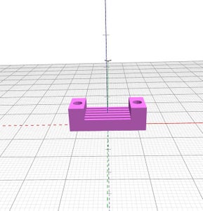

LCD spacer: 53(W) x 24.4(D) x 1.5(H) mm, 1g

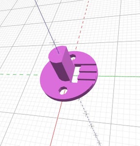

Sensor retainer: 13(W) x 13(D) x 7(H) mm, <1g - 2 required.

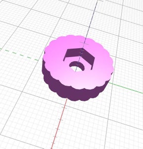

Corner Feet (fits an M4 nut to allow leveling of the box): 16.8(W) x 17(D) x 5(H) mm, 1g - Qty 4

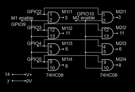

Motor control : GP2 - (1), GP3 - (4), GP4 - (9), GP5 - (12), (connected to two 74HC08)
Motor select : GP9 - (2, 5, 10, 15) Hours, GP10 - (2, 5, 10, 15) Minutes (connected to two 74HC08)
ULN2003 motor drivers POWER - 5V, I1 - (3), I2 - (6), I3 - (8), I4 - (11) (connected to 74HC08)
28BYJ-48 stepper motors are connected to the motor drivers.

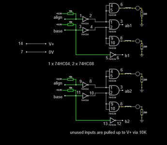

The Hall sensors powered by 3V3 are connected to the following: Hours - GP22 & GP26, Minutes - GP27 & GP28

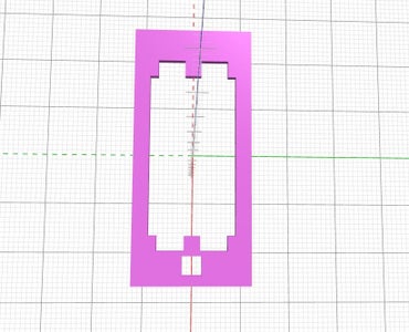

From a suitable supply of wood cut 3 rectangles of size 218(L) x 118(W) x 20(H) mm and into the rectangles cut out the central area.
From a suitable sized 5mm thick acrylic sheet cut out 2 rectangles of size 218(L) x 118 (W) mm into the rectangles cut out the central area.
The central area to be removed is 200-180(L) x 100-80(W) mm along the edges except in the corners which are 20(L) x 20(W) mm, this creates a step in the corners.
Align and clamp the stack and equidistant from the corners drill 4 x 4mm holes through all the pieces.
From a length of M4 threaded rod cut 4 x 80mm pieces and round the ends with a file.
Be sure to verify the dimensions of the elements used and should they deviate from those specified adjust any openings accordingly.
Cut a recess for the display 54(L) x 24.4(W) x 2(H) mm in the centre of the first three layers of the stack (wood/acrylic/wood). Within the recess cut two 54(L) x 2(W) mm slots to accomodate the sockets.
Using a 10mm flat drill bit cut a a hole 5mm deep (a flat drill is used as it creates a small pilot hole), the pilot hole is used to guide a 7mm (dia), drill bit all the way through. This is to accomodate the reset button
Repeat the process using the 10mm flat drill bit at the other end of the box and into the resulting pilot hole drill a 5mm hole. This is to accomodate the set enable switch.
Drill an 8mm hole for the power socket and file the opening until it is shaped to fit the socket.
Using the 3D printed holder for the RTC as a template mark the position of the slot and holes.
The RTC is fitted externally at the back requiring a 12(L) x 2(W) mm slot and two M2 threaded inserts. The threaded inserts allow the cover for the RTC to be removed to replace the battery without having to dismantle the clock.

Step 10: Spiral
The spiral after printing will require some post processing, inparticular along the outer edge of the spiral channel to remove any uneven areas.
Use a fine file or emery board parallel to the contour of the spiral on the top and side to prevent creating an uneven profile.
For the inner edge, wrap and glue or tape in place fine sandpaper around a stout wire and bend it in order to access the inner edge of the spiral.
The slot in the centre of the base may require widening to fit the shaft of the motor this can be accomplished with needle files.
Check the fit at regular intervals during the process the result should be a close fit.
The off centre hole in the base is for the homing magnet.

Step 13: Time Bars
The time bars are vertically mounted next to the slider rails, one for the hours and one for the minutes.
The hour time bar has major markings in one hour intervals from 0 to 12 hours with 15 minute sub intervals.
The minute time bar has major markings in five minute intervals from 0 to 60 minutes with 1 minute sub intervals.
Subject to the clarity of the numbers whose legibility may be affected by aberrations in the printing process post processing may be required. This may involve removal of excessive material with a scalpel or other sharp pointed implement. Or the addition of filler for any undesirable cavities.
Sanding of the surfaces may be required to remove aberrations.
The time bar is verticaly mounted on a 3mm(dia) x 5(H) + 3mm, threaded stub. through a hole in the base.
With a 3mm drill bit carefully drill into the existing hole in the time bar to widen it to fit the threaded stub.
The marking on the time bars are highlighted with black paint.
However, prior to applying the black paint a clear coating is applied, the clear coat seals any small gaps in the plastic that would cause the black paint to run out from the recessed markings into the surrounding area.
Clear out any excessive clear coat from the marking that may prevent the black paint from collecting in the recesses with a toothpick or fine tip brush.
Apply two or more clear coats, allow each coat to dry, sanding between coats and ensuring the recesses are not overfilled.
Paint over the markings with the black paint ensuring the recesses are filled.
Once dry, sand the surface with fine sandpaper to reveal the markings.
Repeat the filling process if any gaps are found in the markings.
In addtion smaller recesses around the numbers may take up the black paint reducing clarity these can be picked out with a picking tool of scalpel then filled in with a compatible colour.
Once the paint in the markings has dried give the whole of the front of the time bar a clear coating.
The time bar slides over the threaded stub and stands vertically parallel to the hollow tube and is held in place by the spiral top.

Align the spiral base plate (small lobe to the right and sensor channels uppermost), with it's large hole sitting over the spindle of the motor. Attach the motor to the base plate with two low profile head M3 x 10mm machine screws and nuts.
The stepper motors fit into the large circular cut outs with the fixing lugs sitting into the smaller cut outs to the left and right. Fix the base plate and motor combination to the top panel with two low profile head M3 x 10mm machine screws and nuts.
The base plate screw fixing holes are recessed however, low profile head machine screws are required to prevent contacting the base of the spiral which could effect smooth movement, seating of the bearing and reliable homing.

Base Crescent
Prepare the base crescent by fitting two M3 x 5mm threaded stubs into the side holes and partially screw in place.
Thread the sensor wires through the large hole and screw the base crescent to the base of the top panel coincident with the base plate small lobe using 2 x M2 x 6mm self tapping screws.
Fit a M2 threaded stub into the hole infront of the small lobe on the base plate.
Push the 3mm brass rods into the 3mm holes in the base plate and through the top panel and base crescent.
Tighten the M3 threaded stubs to hold the rods in place.
Drill two 2mm holes 3mm deep in the top panel using the base crescent as a template and attach with 2 x M2 x 3mm screws.
Fit the slider over the brass rods with the magnetic face toward the spiral.

Taking the spiral, fit the thrust bear washer into the recess, place the thrust bearing over the washer and fit a washer over the brearing. Place two thin slithers of tape across the bearing and base of the spiral extending beyond the edge by ~5mm. This will hold it in place while the spiral is pressed down onto the spindle and removed once the spiral is firmly seated on the spindle.
Fit a thrust washer into the recess in the centre of the base plate.
Press the spiral centre hole over the spindle of the motor.

As there are a total of four Hall sensors (2 per spiral), and to save on GPIO's used the sensors are connected to a separate sensor logic board.
Step 17: Hall Sensor Logic Board
This and all other custom PCB's designed on Eagle 9.6.2 and fabricated by OSHPark
The HC logic series operates from 2V to 6V and therefore can be directly interfaced to the microcontroller operating at 3.3V without recourse to level shifting.
The outputs of the two Hall sensors identified as base and align are each connected to an inverter (74HC04) and each one connected to one of the inputs of a two input AND (74HC08) gate.
Pull up resistors (10k), are connected to the inputs of the inverters forcing the inputs high with no connections to the inputs. They also serve as loads for open drain Hall effect sensors.
There are two such circuits per spiral with the outputs connected to GPIO 22 & 27.
When both sensors detect suitable magnetic fields the outputs of the sensors are low, these are inverted and fed to the AND gate whose output is high. The home position.
If any other input logic combination is detected the output of the AND gate is low.
If a low is detected during the homing sequence an error is generated.
The inputs of the AND gates are also connected to individual AND gates, each have their inputs connected to form a non inverting buffer which can be used to drive an LED. This enables the indication to be used for diagnostic purposes with the jumper in place.
Additionally, the base is also connected to a separate inverter to enable it to be monitored independently of the AND output.
There are two such circuits per spiral with the outputs connected to GPIO 26 & 28.
These can also be used to detect if the slider has dropped when it should be raised.
Step 18: Mutiplexer
Due to a large number of the GPIO pins being used mainly by the SPI display there were 2 pins too few to control both motors directly.
Therefore, I added a muliplexer circuit between the Pico and the Motor drivers.
The initial design being on stripboard prior to the creation of a PCB.
This was a PCB that utilises 14 pin SOIC packages to simplify the build and minimize the size.
This allows four GPIO's to carry the controlling bit patterns for the motor and two GPIO's used to control the external logic to select the required motor.
The multiplexer consists of two Quad 2 i/p AND gate chips (74HC08), one chip per motor.
Each one of the 4 GPIO pins from the Pico are connect to the same input of one pair of gates per chip.
Each one of the 2 GPIO pins are connected to a chip and each one of 4 pins, one per gate.
When the appropriate select pin is high the outputs of the gates on the enabled chip will follow the inputs.
When the appropriate select pin is low the outputs of the gates on the disabled chip will be low regardless on the inputs.
Therefore, any motor can be selected or deselected as required.
The GPIO limitation could also be resolved by using an I2C interfaced display, negating the multiplexer.
However, the method employed is based on the components available at the time of the build.

Step 20: Auto LED
Accent lighting is added using UV LED's in conjunction with glow in the dark elements (sliders).
Each LED is mounted above the slider at the top of its travel pointing downward through the hole in the top crescent and the coincident hole in the top plate, this illuminates the slider at any point along the rails and the LDR is mounted at the top of one of the spiral tops.
The LED and the LDR are soldered at the end of long wires that pass through the hollow tubes with the other ends being connected to the appropriate points of the Auto LED circuit.
The LED's are controlled by a separate circuit that automatically switches them on when the ambient lighting deminishes.
The light sensor is an LDR (light dependant resistor), which is connected as the lower end of a series circuit with a series resistor and potentiometer at the upper end to form a potential divider with the tap point at the top of the LDR.
A potential divider is a circuit whose output voltage is fraction of the input. This being composed of 3 series resistors supplied with 5V.
The variation in the light level changes the resistance of the LDR, more light the lower resistance and less light the higher the resistance. For this LDR used the resistance ranges from ~39R to ~350kR subject to lighting conditions.
The light detection threshold that determines at what level of brightness the LED's illuminate is adjusted by the potentiometer in the potential divider.
We can calculate the voltage at the tap point with the following equation:
Vtap = Vin * Rldr/(Rldr+Rs+Rpot)
We can apply typical values for the LDR and the potentiometer at min/max ranges not including component tolerance which will add some variation. The tighter the tolerance the smaller the component variation from its nominal value.
Vtap min = 5V * 39R/(39R+1k2+0R) = 157mV (LDR and potentiometer at min values)
Vtap max = 5V * 350k/(350k+1k2+5k) = 4.913V (LDR and potentiometer at max values)
The tap point of the potentiometer is connected to the NFET (BS270) which has a typical gate threshold (Vgsth), of 2.1V (1V min, 2.5V max).
Setting the potentiometer at its midpoint of 2.5K, (allowing manual adjustment either side of this value). If the LDR resistance varies from 1K to 4K then this variation will result in a voltage range of 1V to 2.6V, which will switch on the NFET. The exact switch on point will be subject to the Vgsth of the particular NFET.
The drain of the NFET is connected to a 12k resistor which acts as a pull up.
When the NFET is switched off (Vgsth < 1V), the base of the PNP transistor is pulled high by the 12k + 1.2k resistors thus reverse biased and switched off and the LED's are also off.
When the NFET is switched on (Vgsth between 1V to 2.5V), the midpoint of the 12k & 1.2k resistors are pulled low switching on the PNP transistor and the LED's.
The series resistor for the LED's (Rled), is calculated from the voltage drop of the other components.
Vled = 3.1V, Vcesat = ~1V therefore Vresistor = 5V - (Vled + Vcesat) = 5 - 4.1 = 900mV.
The transistor is not in full saturation due to the 1k base resistor limiting the base current to < 200uA.
The maximum recommended LED current (Ifmax), is 20mA, therefore Rled = Vresistor/Ifmax = 900mV/20mA = 45R
45R is not a standard value and the next value that maintains the current under 20mA is 47R (E6 or E12 series).
Additional, details can be found in Auto LED Switch : 6 Steps - Instructables

Step 23: Operation
Power (5V), from a suitable supply is provided by a USB-C lead connect to a socket on the lower right hand side at the back.
At power on or after a reset.
The homing process will begin, displaying "Please Wait ... Homing"; this ensures that the spirals and the sliders are in the starting (home), positions with the ball bearing at the bottom.
First the hour spiral then the minute spiral.
If the slider is already at the bottom and the spiral is aligned, the spiral is homed.
If the slider is part way up the rails, the spiral will rotate until the slider is at the top at which point it will drop to the bottom while the ball bearing roles down the spiral to the bottom. When the spiral is aligned, the spiral is homed.
There is a 60 second timeout on the homing process for each spiral. If the timeout expires the display will show "Homing Failed"; in red text which will be reflected in the time display also in red.
With both spirals and the sliders aligned the display will show "Homing Passed", in green text which will be reflected in the time display also in green.
The current time from the RTC will be displayed.
The hour spiral will rotate with the ball attached to the slider and move to indicate the hour on the vertical hour scale.
The minute spiral will rotate with the ball attached to the slider and move to indicate the minute on the vertical minute scale.
The minute spiral will increment each minute until the hour passes and reset to home position.
The hours spiral will reset to the home position and increment to the current hour each hour.
The spirals operate on a 12 hour cycle and will reset to the home position at 1200 and 0000 hours.
A reset can be initiated by momentarily pressing the button on the lower left on the back and this will start the homing process.
To set the time.
Flip the switch located on the lower right at the back.
The display will turn blue.
Press the top left button next to the display showing a "H", for each hour to be set 0 to 23.
Press the top right button next to the display showing a "M", for each minute to be set 0 to 59.
Press the bottom right button next to the display showing a "U", to update the new time.
If you wish to blank the digital display.
Press the bottom left button next to the display showing a "B".
Once complete, flip the switch on the lower right back the display will turn green and show the updated time assuming the display has not been blanked, in which case nothing will be displayed.
The time will be updated on the spirals.
