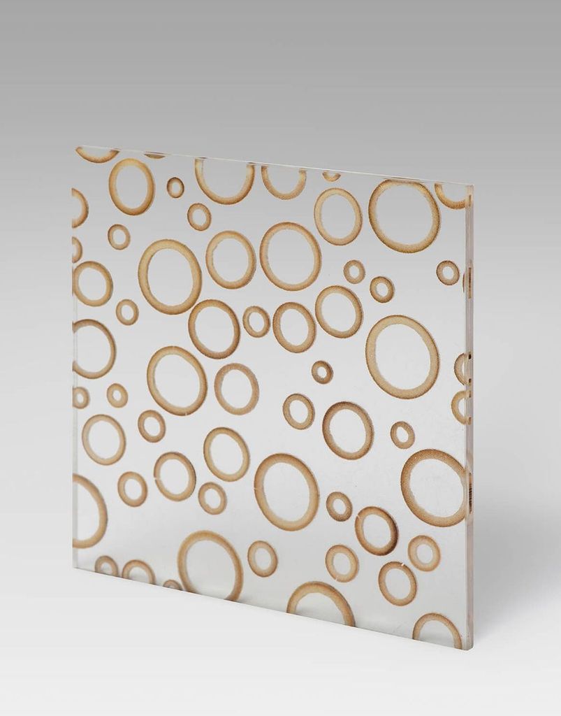

Step 3: Experiments
Here are my experiments with the shape of the cutout. I chose the fractal cutout because I preferred how it looked.
*The reason it looks white is I kept the masking tape on the acrylic board after laser cutting.
