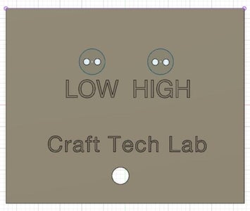

1x Housing (Top, bottom, and needle tip 3D printed) - I used a Prusa MK3S to print mine.
Step 2: Print Housing and Needle Grip
I suggest printing the housing and needle grip first as they are essential for the following steps and take longer to print. You can also create the logic probe without the housing, but you will need to skip some of the steps later on.

- Press the PCB down as far as possible and then solder the LEDs to the PCB, threading them through both the housing and PCB.
