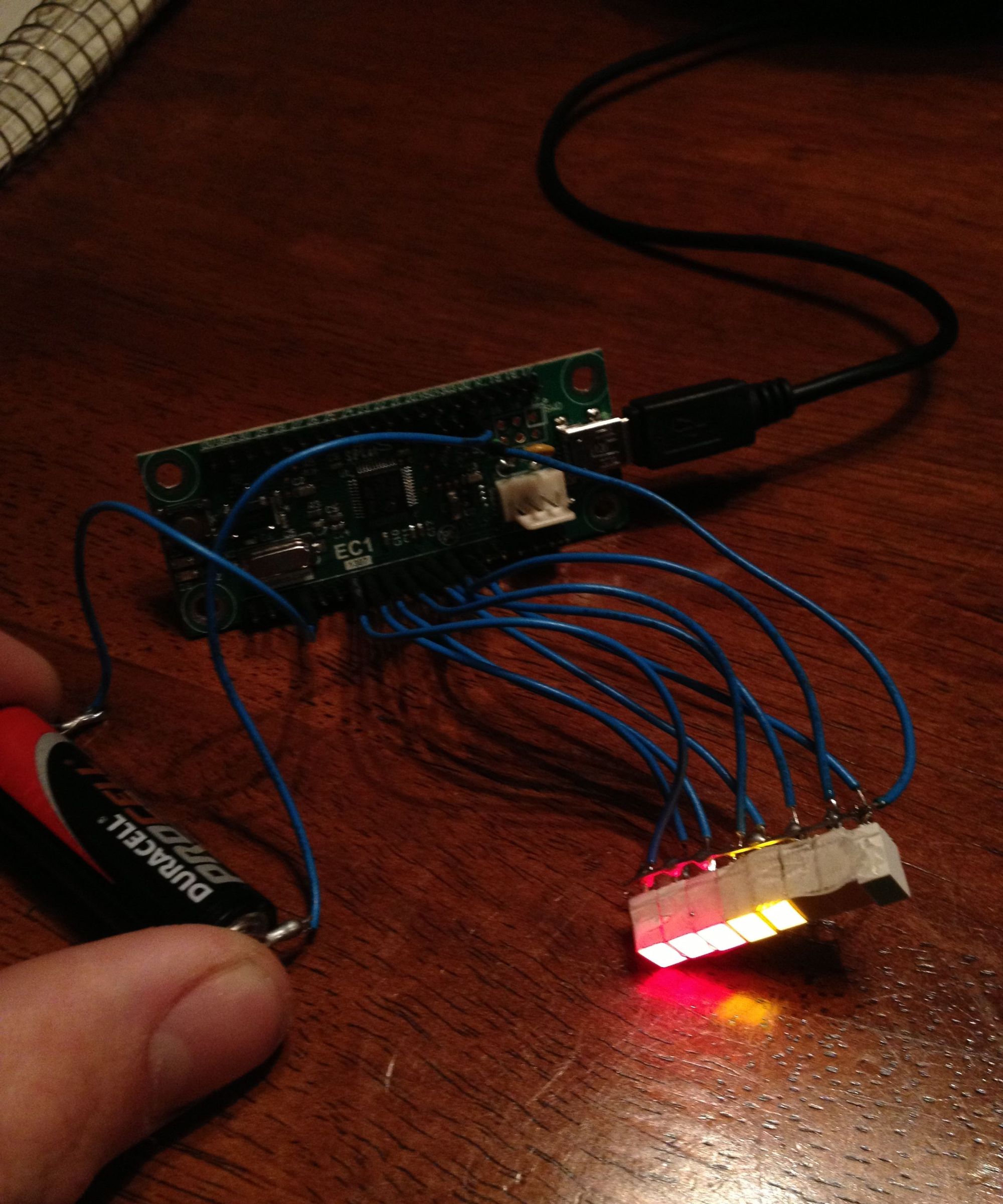

Lets start by soldering one female header to each of the 7 33 ohm resistors
Now lets solder each resistor to a leg of out display and one more header to the common cathode
Step 3: Solder the Button
This button will act as the trigger to "roll" the dy
Lets solder one header to each terminal, simple enough right?
Step 4: Hook Up Our EC1
Now that everything is soldered lets plug them into our EC1
Making note of the alphanumeric displays pinout connect the headers in order A-G to pins 6-12 on the EC1.
These correspond to outputs 2-8.
Now connect one header from the button to the 0V pin and one to pin 20 (input 1)
Now we are finished connecting things to our EC1 and we can plug it into our PC via USB and connect to it running SPLat./PC
