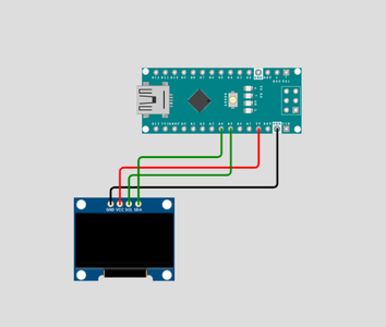

The connections from the Arduino pro micro to the OLED display:
GND to GND
VCC to 5V
SDA to A4
SCK to A5

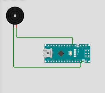

The connections from the Arduino pro micro to the speaker:
black wire to GND
red wire to -3

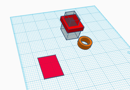

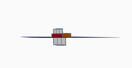

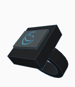

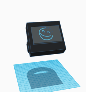

Use a 3D printer to make a box the size of the OLED display and the same color as the ring. Make the box hollow and
with a lid. The lid should have a frame that exposes the screen itself, but not the blue circuit. then put the electronics
