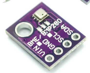

In the example, the temperature and atmospheric pressure will be displayed, using the BMP280 sensor or any other sensor that supports I2C access.
The program allows us to store a day of data as long as we measure after a few seconds, which is suitable for weather variables, as in the present example
a) ESP01 CPU US $0.49/lot of 10 units
b) Digital barometric pressure sensor BMP280 or BME280 US$ 0.60

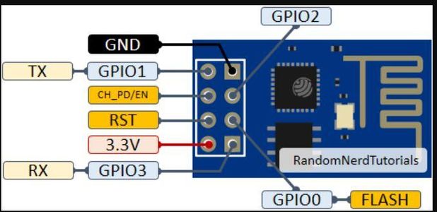

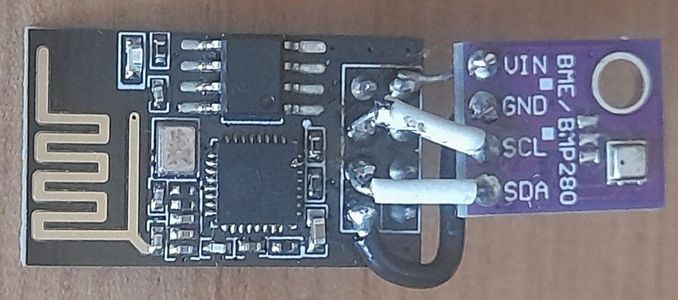

Step 2: The Circuit
The only solders necessary are those that allow the connection of the ESP01 with the sensor through 4 wires:
- Vcc, 3.3 Volts.
-GND,
- SDA to IO pin 0 of the 8-pin connector.
- SCL to its IO 2 pin.

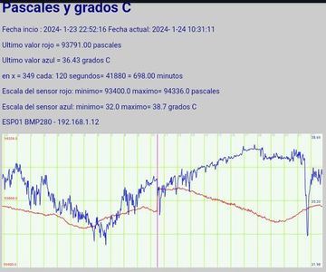

Step 8: Results
In the figure you can see a screenshot that shows the pressure, in Pascals, and the temperature in degrees Celsius.
A vertical line indicates the separation between the current data and the previous day's data, which is swept away as the measurement continues. To the left of the magenta cursor is the current information. On the right, it is the one from the previous day.
Considering the small cost, it is feasible to make several specimens and measure, for example, temperatures in different parts of the house.
