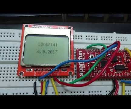

Step 3: Setting Up Hardware
OLED Pin Connections
OLED - ESP32
1. GND - GND
2. +3.3v - 3v3
3. SDA - Pin 21
4. SCL - Pin 22
