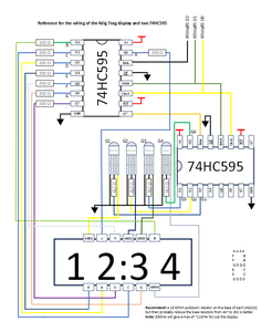

  • Displays the time using a common cathode 4-digit, 7-segment display
  • Uses three (3) GPIO pins to operate the 12-pin display through the use of two generic shift registers (74HC595)

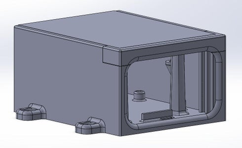

Step 5: Highlights of the 3D Printed Enclosure (STL files provided):
  • Simple to print: no support material needed, under 10x10x10cm size, plus the lid
  • Versatile design that can adapt to many modules (ESP32 Development board, Arduino Nano, RP2040, TP4056 lithium battery management module) with up to 3 standard sized perforated boards: 7x3cm, 7x5cm and 6x4cm
  • Interchangeable face plate allows for different interfaces between the internal circuitry and the outside world: displays, buttons, LEDs, potentiometers, rotary encoders, and sensors. These components can be mounted on the 7x3cm perfboard
  • Sturdy lid held on with two hidden M2 screws
  • Decorative (sort of) feet that can allow for easy mounting of the enclosure with screws

The Circuit
The schematic of the circuit is provided above. If you plan to modify the pin layout, just be aware that some GPIO pins do not have all the same functions as others. For example, some pins do not have an internal pull up resistor, so pinMode(34,INPUT_PULLUP); will not work as expected because there isn’t a pull up resistor for pin 34. You can find a list of pins and functions in this tutorial by Random Nerd Tutorials. Initially, I had planned for the display. When it looked like I would not get the translucent acrylic, which was essential to be able to see it, I abandoned the plan. However, I learned about the multitasking that the ESP32 could do, and decided I wanted to take advantage of it. So, I added the circuitry back into the project for the display. It added a lot more work at that point, but I am glad I did. You can see in the pictures, the change of plans.
There are some 100 nF capacitors, these may be fine to leave out. Many people on the internet suggest placing one such capacitor as close as possible to the power pins of each integrated circuit (the shift registers in this case) as a general practice. I thought it might help with the analog measurement of the LDR.

Displays the time using a common-cathode 4-digit, 7-segment display
On a seven-segment display, each segment is an LED light and is labelled ‘a’ to ‘g’. In a common cathode display, all seven of these have their cathodes connected to a single pin. So, if that pin is low, and some are the a-g pins are high, then those segments will be lit up. In a 4-digit display, each digit has its own cathode. Then all four ‘a’ segments, use the same pin; all four ‘b’ segments use the same pin, etc. Since this is a clock, one extra pin, which is part of the 3rd digit (from the right) is used for the colon (‘:’). Thus, there are 12 pins to control the 29 LEDs. The microcontroller has to quickly pull one cathode low and bring the correct combination of segments high to illuminate one digit. These are switched off, and the next digit’s cathode is pulled low and the segments for that number are pulled high, etc. If the switching can happen fast enough, then these four digits appear to all be continuously on because of a phenomenon of “persistence of vision”. If the switch is not fast enough, the numbers will appear to flicker, or even worse, flash continuously. In this project, the microcontroller uses only three GPIO pins to control the 12 pins of the display by using two shift registers.
Uses three (3) GPIO pins to operate the 12-pin display through the use of two generic shift registers (74hc595)
These 16-pin, through-hole, shift registers require three pins from the microcontroller. These are connected to “shift register clock input’ (SHCP, aka the ‘latch’ pin, on pin 11 of the IC), “storage register clock input: (STCP, aka the “clock” pin, on pin 12), and “serial data input” (DS, aka the “data” pin, on pin 14). The microcontroller uses three GPIO pins (21, 19, and 18, respectively on the ESP32) to provide the input. Both shift registers have their latch and clock pins connected together. Then pin Q7’ which is pin 9 of the IC, is connected to the data pin of the second shift register. This way, the function, displayOneDigit(), brings the latch pin HIGH so that the shift registers can accept data, then shift outs one byte (8 bits) that will determine which digit on the display will be affected, and then a second byte to determine which segment will be lit. This second byte is sent starting from segment ‘a’ and ending in segment ‘g’, and if necessary, the last bit is also put high for the colon. The clock pin will cycle high and low, repeatedly, and on the rising edge of that signal it will take the value of the data pin, which will be either high or low, as the value of the next bit. Once both bytes have been transmitted, the latch goes low and the dislayOneDigit() function ends. Although discussed later in the multitasking section, there is a quick pause and then the cycle repeats for the next digit. By going through one digit after another fast enough, the display appears to have all four digits and the colon lit simultaneously.
As you can imagine, the shift registers are not very smart, they do not know what numbers are. So, it cannot accept a number like ‘2’ if you want to show a 2. You actually have to send the pattern to represent which LEDs in the seven segments are lit. The segment “a” starts at the top and the order goes clockwise around to the top left, with the central segment being ‘g’. So, to get a ‘2’ to show, the ESP32 will send the first byte for the digit, then for the ‘2’ the 8 bits sent right to left is ‘01011011’, which represents the segments ‘: g f e d c b a’. The conversion of the number into the correct pattern saved to an array, is handled by the function parseTimeData(in Hour, int Minute). The pattern for the numbers is handled by getDigit(byte number). The two patterns for each number are used in displayOneDigit(byte n).
Example code for an ATtiny85, two shift registers and the display
My original thought was that I would have a dedicated ATtiny85 to control the display. This microcontroller has 6 digital pins, and thus is the reason I had set up the display with two shift registers. There are man tutorials on how to program the ATtiny85, so I won’t describe that here. At one point I had decided to forego the display entirely, but changed my mind near the end of the semester to see if I could get the ESP32 to multitask the control of the display. So, I just ported the code and wiring that was set up for the ATtiny85 to the ESP32. If I thought about it, and used four GPIO pins of the ESP32 for the cathodes of the display, the second shift register would be unnecessary, and the multitasking to the display much faster. In any case, I am including the code I used for an ATtiny85 when I prototyped the shift registers and the display if you just want to try without any time keeping. In this code, I used an Arduino to send numbers to the ATtiny85 and it would display them on the display. For example, if I sent 1256, then the display would show 12:56. This code can be adapted if you have shift registers and another method of tracking time (real time clock or GPS, etc.), or if you had a sensor and wanted to visualize the value on the display. Make sure the shift registers, Arduino and ATtiny85 all have their ground lines connected. The sample code has the Receive pin (rx) f the ATtiny85 as D3, and the Transmit pin (tx) is D4. Since both ATtiny85 and Arduino are communicating to the computer, connect the Tx pin of the Arduino to D4 of the Attiny85 (physical pin 3); and if you want to print from the ATtiny85 then the Arduino Rx pin to D3 (physical pin 2 of the ATtiny85). Ensure that the Arduino has a “BareMinimum” sketch loaded onto it, and that its serial monitor sends a ‘new line’ ending, or both new line and carriage return. I was using 5 volts for everything in this set up.
Regarding the 2N2222 bipolar junctional transistors for each cathode of the display. If running at 5 volts, and the red LEDs of the display each drop 1.8V for a forward voltage, then each segment would draw ((5V-1.8V)/220 Ohm) about 14.5 mA. So, if all seven segments were on, the current would theoretically be about 100 mA, which is too much for the second shift register to sink in one of its pins. So, instead of pulling the output pin of the second shift register low to sink current, it is pulled high to use the transistor as a switch, and connect the cathode of the display through the transistor to ground. (You would have to use the transistors if you were using these same 220 Ohm resistors & GPIO pins instead of the second shift register.) If you increase the resistor values between the first shift register and the display, these transistors may not be needed, but then you have to reverse the binary pattern of zeros and ones in the getDigit() function.
As mentioned, I had to design and print an enclosure as a requirement of the project. It was supposed to be either 3D printed, or laser cut, or both. Since I did not see myself ever using this clock, I wanted to design something versatile that I could use in a future project. I have some calipers that I used to double and triple check the dimensions of all the parts, and the spacing of pins and holes, so that I could get an exact placement of each part. Generally, I gave about 0.25mm spacing for clearance, but that must depend on your 3D printer. And since it was my first 3D print, I wanted the design not to need any support material. The most significant part of this was the placement of the hole for the USB cable. To get the hole without any need for support material, it was pushed up so he hole is part of the lid.
For my first 3D print, I am quite pleased with the enclosure, and have included the files below if you want to print it. You might find it useful even if you have no interest in the clock or even in the ESP32. The enclosure is basically a box, with a sliding lid. If you are not doing the same project as this, you would only need the box and the lid for 3D printing. The front plate is a separate piece of acrylic that is 7cm wide, 3.9cm high and 3mm thick. This seems like a standard thickness of different materials. My original was cut with the laser cutter, but when I added the display, I found a 6 inch square piece of black translucent acrylic in Toronto for about $5 Canadian dollars. This acrylic was not too difficult to cut by hand. I tried to score it several knife cuts along a ruler. When I tried to bend it, most of it broke on the line but not all of it. When I used a small hack saw, it was rather easy to cut, so I don' think I will try to score and cut it again. I filed the edges, and drilled out the holes using the laser cut piece as a template. Any holes that needed widening, I used a rat-tail file. All this to say, that the front plate allows for the enclosure to be easily customized without having to 3D print the whole enclosure.
The enclosure is designed to hold three generic perforated circuit boards: one 7x3cm, one 7x5cm and one 6x4cm. This project only used the first two, but there are stand-offs with holes for M2 nuts and screws in the floor to hold the 6x4cm perfboard. The 7x3cm board sits vertically 0.82cm behind the front plate. This distance is just enough to fit the display. This meant that two small supports were 3D printed for the buzzer and the LDR, which are exposed through the front plate, as well as the pushbutton (10mm tall). The front plate and vertical perfboard slide into slots. These are a perfect snug fit and do not need any adhesive or screws. When all the screws are in place, shaking the enclosure is silent - no rattling.
The microUSB cable plugs into the ESP32 module. Since the board uses male header pins and were plugged into female header pins on the 7x5cm board, then almost any small module that uses these pins should be able to be plugged in with a similar sized microUSB or miniUSB or USB-C cable. So, an Arduino Nano, RP2040 development board, or a TP4056 module for a lithium rechargeable battery. This later module does not use the typical 2.54mm pin spacing, but it would fit, with some minor angling of the pins. Caution for any board you intend to use, there isn’t a lot of overhead room so the other components on the development board (or module) must not be higher than the microUSB port. Most perfboards seem to be 1.6mm thick, and the smaller USB connectors I mention above that I have used all just fit under the lid. However, a module with male header pins, plugged into female header pin on the 7x5cm perfboard, with a typical through hole integrated circuit in an IC socket, would be too high and would prevent the lid from closing.
The lid is fairly sturdy, and is held in with two M2 nuts glued into the pillars on the lid, and two 10mm M2 screws from the underside of the enclosure and through the two pillars. The inside of the pillars are wide enough for a screwdriver from the bottom and the end of these channels have a fillet for easy insertion of the screws. The horizontal perfboards (7x5cm and 6x4cm) are similarly held with M2 screws with the nuts glued into place.
There are four feet on the outside of the box. These are included to give some character to the appearance, so the enclosure was more than just a box. I added a small dimple at the centre bottom of an impression on the top of each foot. These are meant to be used to drill a pilot hole for a screw hole if this enclosure was to be mounted onto something more permanent or if attached vertically.
I have included the SolidWorks technical drawings at the end of the Instructable. They were required for the completion of the project. The box is rather complex with numbers everywhere, and would have probably been better on two pages. Maybe someone will find it helpful.
Note: there was an error in my print, but I did not have the time to correct it before sending the STL files to be printed. The shelf for the lid at the top of the enclosure partially blocked the 7x3cm perfboard from sliding in. Without the time to correct this, I knew I would have to trim both sides of this perfboard. However, the error is corrected in the SLT files here by enlarging the front of the lid so the shelf does not extend to where the vertical perfboard slot is. If you compare the images to the photos, you can see the small different where the front of the lid mates with the box.
