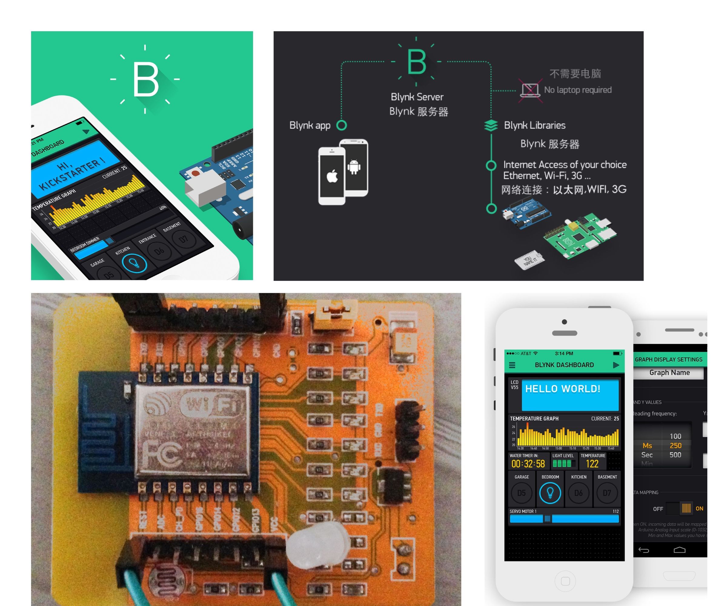

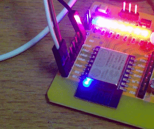

Step 3: Flash/Power an LED With Blynk
Setup hardware as shown in pic...
Connect the USB-TTL to pc and upload sketch to ESP-12
Note: GPIO0 should be LOW and CH_PD and RST should be HIGH for first time flashing the board
GPIO0 should be LOW when uploading sketches
Remember use a 3.3V USB-TTL
connect RX of board to TX of usb and TX of board to RX
SKETCH:
edit auth code, ssid and pass

Step 4: Results
Enjoy...

"Setup hardware as shown in pic..."
Unclear... can you please send us a picture more in focus?
