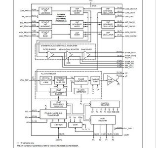

Step 1: Programming the TV Tuner
I did program the PLL inside the TV tuner and the broadband video switch by using Arduino nano throw I2C
the TV tuner has a three-band mixer/oscillator and PLL for the terrestrial tuner
what is good about using a TV tuner instead of using an old CRT TV is that I can increment the programmable divider by 1 which gives a clear picture, the video and audio come from the tuner, I used the MM1630 video switch to amplify
the video coming from the tuner because the video format coming from the tuner is CVBS format and it's a weak signal.

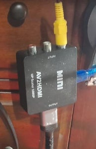

I convert the CVBS to HDMI, I did use an AV2HDMI converter I get HDMI to VGA cable connected to the VGA monitor.
I did explain the phase-locked-loop in great detail in another Instructables project.

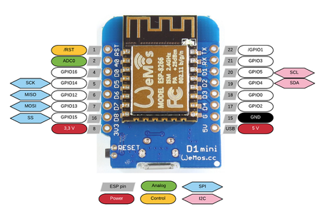

Step 2: Programming the ESP8266
I got the code from GitHub cnlohr/channel3 I got what I want only from the code, and I did modify the code to work in Arduino.
I used visual studio code IDE and platformIO to code everything, the platformIO is so powerful it helps me to get everything right if I used Arduino IDE I will give up on the first try, the visual studio code IDE has a C/C++ IntelliSense, debugging, and code browsing and UI Themes for C/C++ extension, which helps a lot to get the code right.
connect a small wire to GPIO3 RX acts as an antenna and remote IR receiver to GPIO 0.
To start a project in platformIO open the project wizard name your project and select your board and framework which is Arduino framework.
make sure all the code is in the platformIO packages framework-arduinoespressif8266 libraries folder.
I did one example and I used remoter control to scroll throw the screen demos.

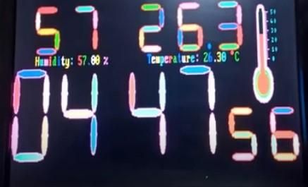

Step 3: Final Product
I am working on a similar project, like the picture above to broadcast a real-time clock, when I finished the project and make sure nothing crash I will upload the code for the new project.
