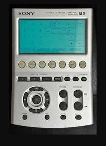

  10. Remote control

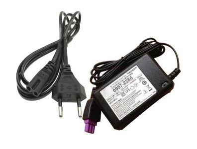

  12. HP printer power supply outputs 32v

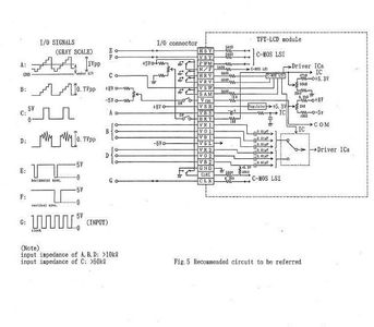

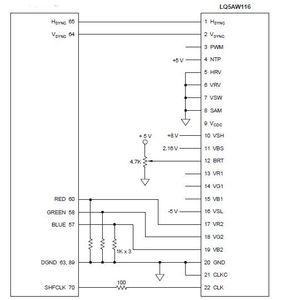

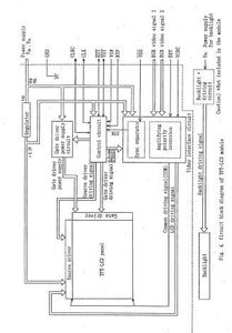

Step 1: SHARP LQ5AW136 TFT-LCD Display
INTRODUCTION
SHARP AVTFT displays are generally meant to be
driven with either an NTSC Composite Video or with discrete
RGB Video signals. SHARP’s AVTFTs have video
compatible inputs that enable easy interfacing with a camcorder,
a VCR, or the video output from a CCD camera.
Most AVTFTs have two video input channels. One channel
may be an NTSC Composite input and the other will
be a discrete RGB Video input. An example of this video
input configuration is the LQ056A3CH01.
The LQ5AW116 is a dual video input channel
AVTFT with discrete RGB inputs. It has a composite
video input, but the display electronics merely use this
input to strip off the sync information, disregarding the
video content of the composite signal.
The LQ5AW116 was designed for discrete RGB
video sources.
LQ5AW116/136 OPERATION
The LQ5AW116 is an AVTFT (Audio Visual Thin
Film Transistor) LCD. It can display one of two video
input channels by making pin 7, VSW = HIGH
(channel 1) or VSW = LOW (channel 2). The display
can generate an LCD pixel clock internally or it can use
an external clock depending on the setting of CLCK
input. If the video signal input is NTSC decoded RGB,
then CLCK = HIGH, and an internal PLL will generate a
pixel clock that is phase-locked to the sync input. By
doing this, pin 22 (CLK), pin 1 (HSYNC) and pin 2
(VSYNC) become outputs. If an RGB video signal is
available and the user would like to control the LCD
timing, set CLCK = LOW, making CLK, HSYNC, and
VSYNC inputs.
Pin 8 (SAM) determines the external clock sampling
mode. In Independent Data Sampling mode
(pin 8 = HIGH), the external clock (18.2 MHz to 19.6 MHz)
is three times faster than in Simultaneous mode
(pin 8 = LOW) and video data is sampled sequentially
(first red, then green, and then blue). In Simultaneous
mode, all three video inputs are sampled at the same
point in time with a slower clock (6.8 MHz to 7.6 MHz).

// SONY REMOTE CONTROL
// Define constants for IR remote control codes
const unsigned int IR_UP = 752;
const unsigned int IR_DOWN = 2800;
const unsigned int IR_RIGHT = 3280;
const unsigned int IR_LEFT = 720;
const unsigned int IR_CHANNEL_UP = 144;
const unsigned int IR_CHANNEL_DOWN = 2192;
const unsigned int IR_INPUT = 2640;
const unsigned int IR_DISPLAY = 1488;
const unsigned int IR_VIDEO_1 = 48;
const unsigned int IR_VIDEO_2 = 2096;
const unsigned int IR_VIDEO_3 = 1072;
const unsigned int IR_MENU = 112;
const unsigned int IR_OK = 6272;
const unsigned int IR_RECALL = 3536;
const unsigned int IR_VOLUME_UP = 1168;
const unsigned int IR_VOLUME_DOWN = 3216;
const unsigned int IR_0 = 2320;
const unsigned int IR_1 = 16;
const unsigned int IR_2 = 2064;
const unsigned int IR_3 = 1040;
const unsigned int IR_4 = 3088;
const unsigned int IR_5 = 528;
const unsigned int IR_6 = 2576;
const unsigned int IR_7 = 1552;
const unsigned int IR_8 = 3600;
const unsigned int IR_9 = 272;
