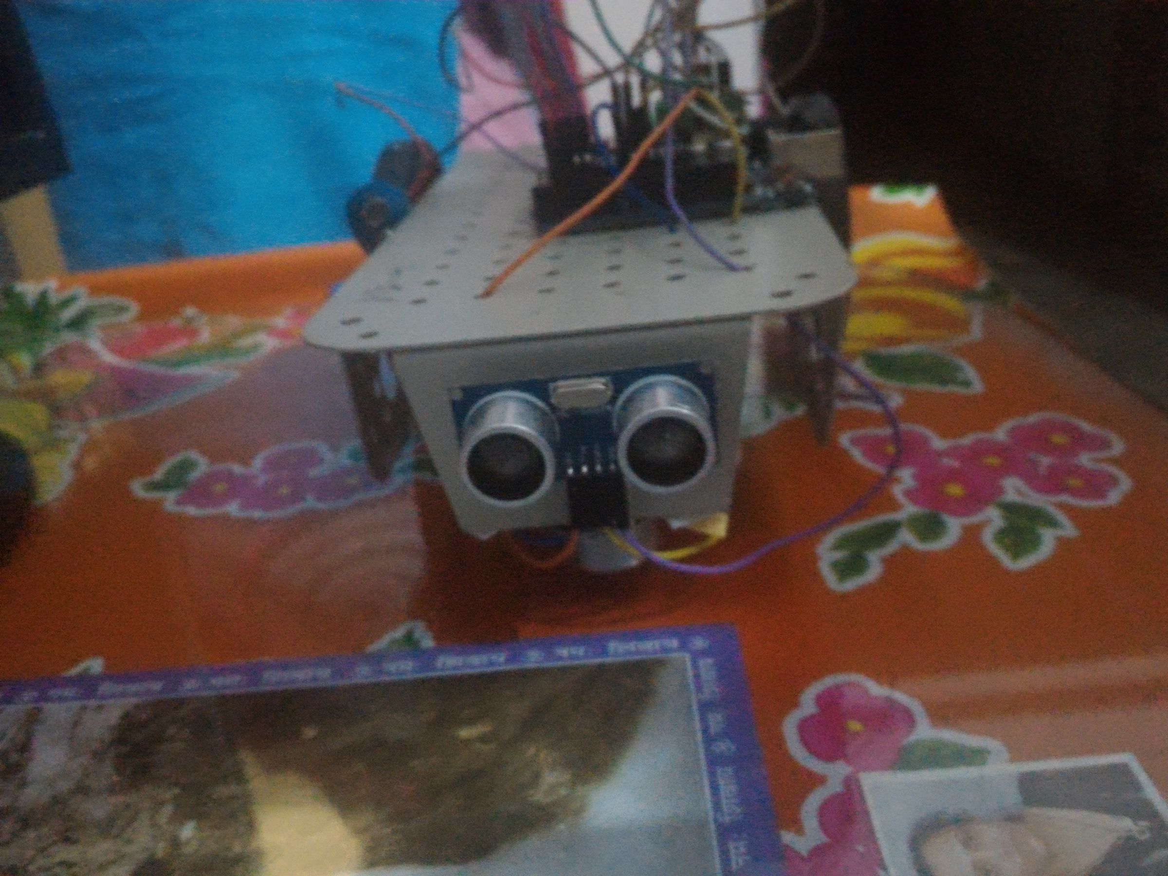

1) Connect the ESP Module.Connect TX-RX to the Arduino pin numbers that you've defined in the code In my case they were 2,3.In order to power Esp8266, I have used breadboard power supply(3.3 V). The main reason was that my Arduino wasn't able to provide required current supply.Make sure to common the ground of Arduino and esp8266 with that of breadboard power supply.
2)Connect the Ultrasonic sensor and RGB LED.Here only one LED is shown.In RGB led, we have 4 terminals to control Red, Green and Blue components and a ground as shown in the figure.Do remember to connect a resistor(330 ohms)in series to each anode terminal.Here in diagram connection might be different as defined in code by me or you.Then connect DHT22 and LM35 carefully.
