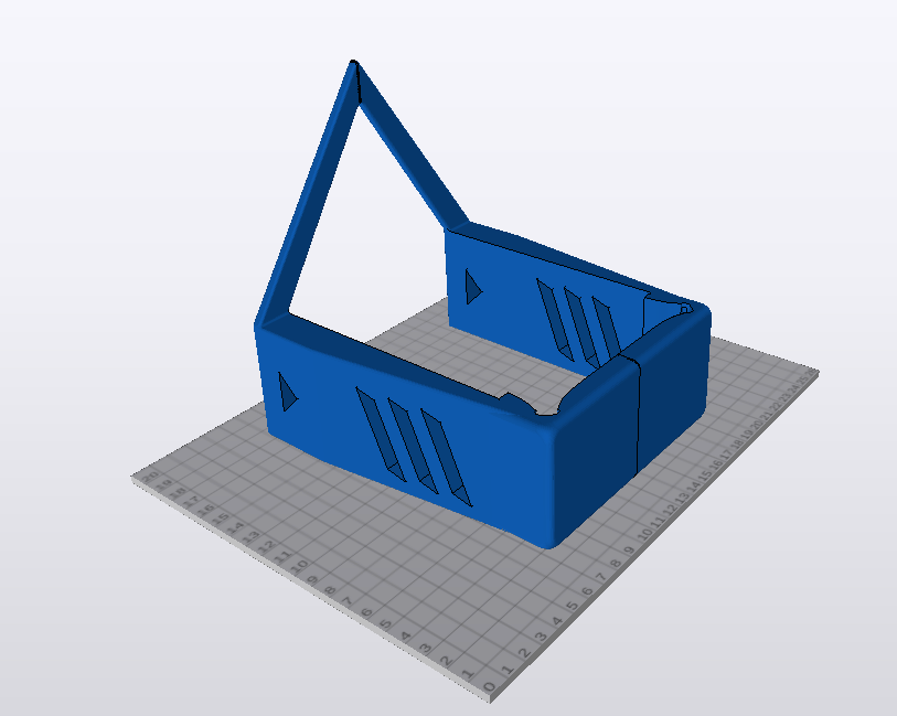

Super thin frame and 3D printed/printable
Use a lot less filament, greatly decrease print time, and (surprisingly) increased dropping and bending tolerance.
A little flimsy, bend (not permanently) under force, and some parts may snap if too much pressure is applied.
