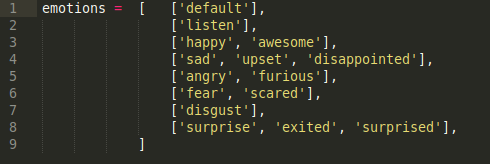

Can Ewon understand emotions?
Now that Ewon has a name I'll be using Ewon instead of calling it a robot. Okay so emotions, short answers no, Ewon cannot understand emotions so what we are gonna do here is make Ewon detects emotion in our speech using keywords and then play the corresponding facial expression associated with it.
To achieve this what I have done is a simple sentiment analysis script. There are 6 different emotion classes.
Happy, Sad, Anger, Fear, Disgust, and Surprise. These are the main emotion classes and each of them has a list of keywords associated with the emotion. ( for example good, nice, excited, all come under happy emotion).
So whenever we say any of the keywords in the emotion class the corresponding emotion is triggered. So when you say "Hey Ewon!" and wait for Ewon to speak and I continue saying "Today is a nice day!", it picks up the keyword "Nice" and triggers the corresponding emotion 'Happy' which triggers the facial expression for Happy.
