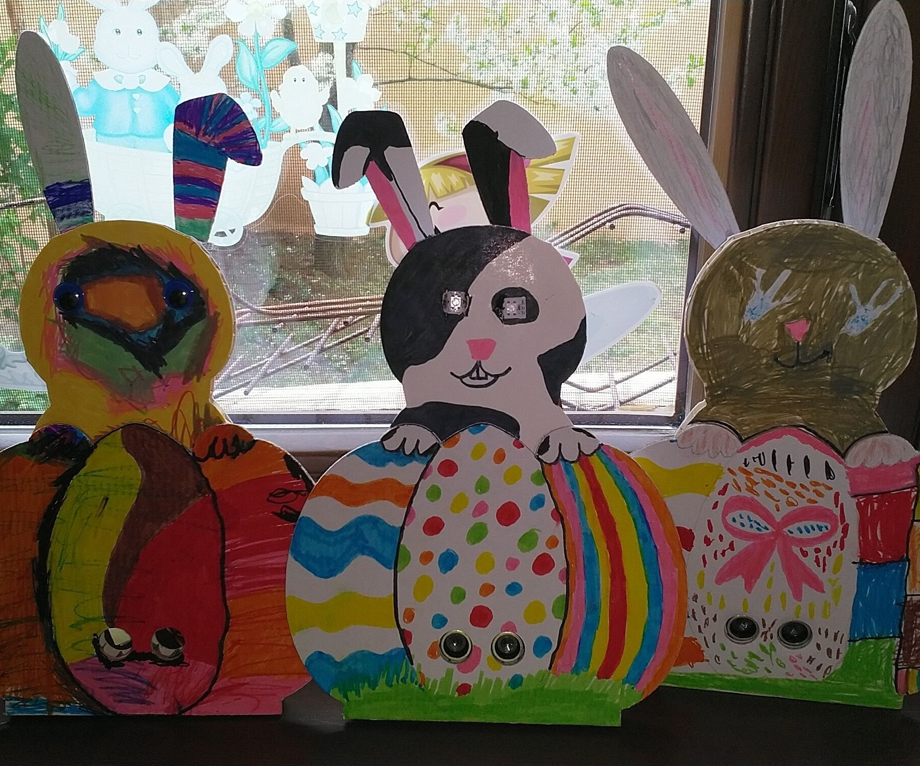

Introduction: Easter Rabbit Radar
A lovely Easter toy and decoration.
With Arduino and distance sensor which controls two organs and LEDs.

Step 2: Construction
Fotmara cut cardboard sheet that can be colored later.
I used a pre-designed template that I cut on wood. PDF, AI, DXF. file
It can be painted before mounting.
This solution can be used in several versions and for example: Christmas, helloween ......
