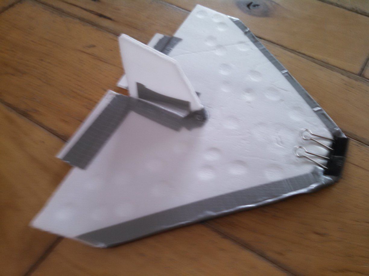

Introduction: Easy, Cheap Locator Beacon <$5
Simple general use plug and play locator beacon for lost R/C model, transmitter hunting, etc... I know it looks odd because I used an old empty medicine container as a water resistant project box to encase the beacon.
