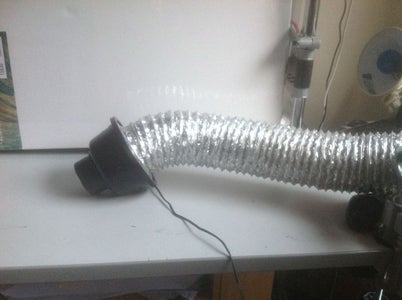

Step 2:
Take your container lid and cut a hole slightly smaller than diameter of your vent hose.
Step 3:
Now glue the lid to one end of the venting material.
Step 4:
Now you need to fit the fan into the bottom of container by cutting the appropriate sized hole for your unit. The inlet end of the fan (that sucks air in) needs to be outside and the other end that expels air needs to be inside the container. You want this to be a SNUG fit with no gaps. If you have any, fill with hot glue, foam, putty or whatever. You can see the hole cut in the container in the first pic and with the fan fitted in the second.
Step 5:
Now you can push the lid onto the container, making sure it fits firmly. Cut whatever holes or notches you need to allow your wires to feed through to the outside. You once again don't want any gaps - we are aiming for as airtight as possible. I also added a switch, but that is not necessary. You can just turn it on and off from your power source.
Step 6:
Connect to power source and your portable fume extractor is done!! I am using a 6 volt adaptor plugged into mains power, but could just as easily use a 6 volt battery. Now simply throw the end through a window to vent fumes outside and attach the fan to a box (as is shown next) or just hang it above your work area.
Take it with you and use just about anywhere! In a pinch, even a cardboard box could work if you cut a hole for the fan.......
