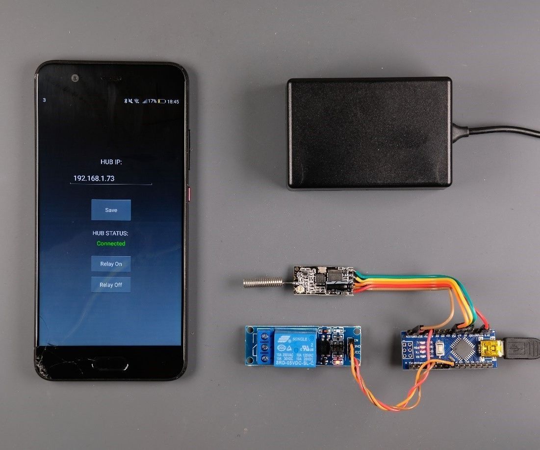

Step 8: DroidScript Code
Now we are starting to build a collection of nodes to work with our wireless IOT system, we should make the android application for controlling and reading data from the nodes neater and easier to expand.
The easiest way to do this is to introduce tabs for each type of node, and to break the code into separate ‘.js’ files for each tab. This simplifies the main program and makes it easier to understand and navigate the program.
Open the DroidScript web editor and create a new app. We will be using parts of the app we wrote in the previous tutorial but rearranging the layout into separate files.
Click the “+” new file button and give the file a name. Create 3 files, for the three tabs we will use, one for temperature, one for the relay module and one for settings (setting the IP address).
Inside these files, we need to create functions to draw the layouts for each tab that can be called by the OnStart() function.
