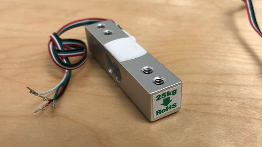

Load Cell
A load cell is the metal structure shown above. They come in all different shapes and sizes (examples) and they make it quite easy to measure weight/forces. The main component of a load cell is called a strain gauge which can look something like this and is embedded in the white portion of the load cell. The strain gauge is a resistor that has a variable resistance based on force. Here are a few videos that do a reasonable job of explaining this:
Luckily, when using Phidgets, you don't have to worry too much about the technical aspects of this, you can just plug it into the correct Phidget (Wheatstone Bridge Phidget) and start measuring weight.

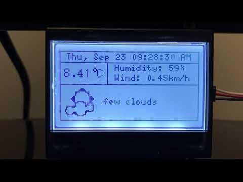

Step 5: Result
You can see the result in the video above. In that example a Graphic LCD Phidget was used to display the weight information, however, it is not required. That video tests the low end of the scale (the weight was only 12g), however, you can increase the capacity up to 25kg (55lbs) with this scale.
