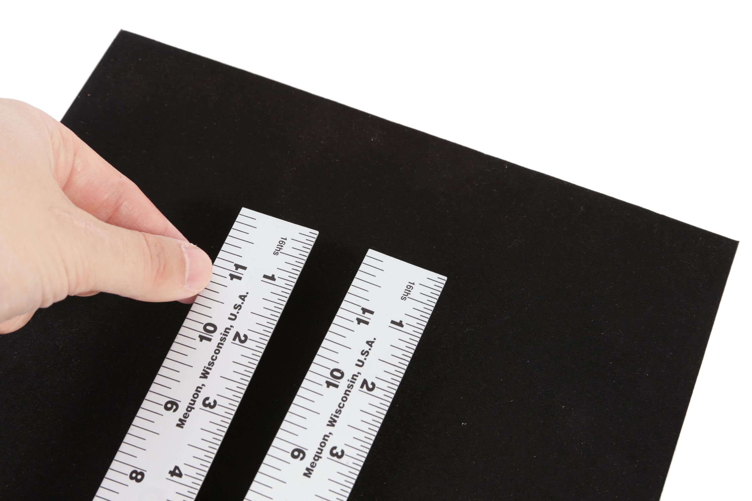

Step 11: Attaching the Rulers
The rulers will get attached with nylon nuts, bolts, and spacers. Plastic hardware was chosen because it is not conductive.
This is important because it means that there are no high voltage connections found outside of the case. If metal hardware was used, it would be carrying 12,000 volts from the ring terminal, through the bolt, to the nut on the outside of the case. This would highly increase the chances of electric shock. By using the plastic, the high voltage is constrained to the inside of the frame and has no easy pathway out.
Pass a nylon bolt through the top of one of the rulers, and then slide the nylon spacer over its threading. Pass the remainder of the bolt through the frame's backing from front to back, and then fasten it in place with a nylon nut.
Repeat this process for the second ruler.
Once both rulers are fastened tightly in place, position the bottom of the rulers such that they have a small gap of approximately 3/16" between them. They should be arranged so that form a large V-shape with the rulers and are about 3/4" apart at the top.

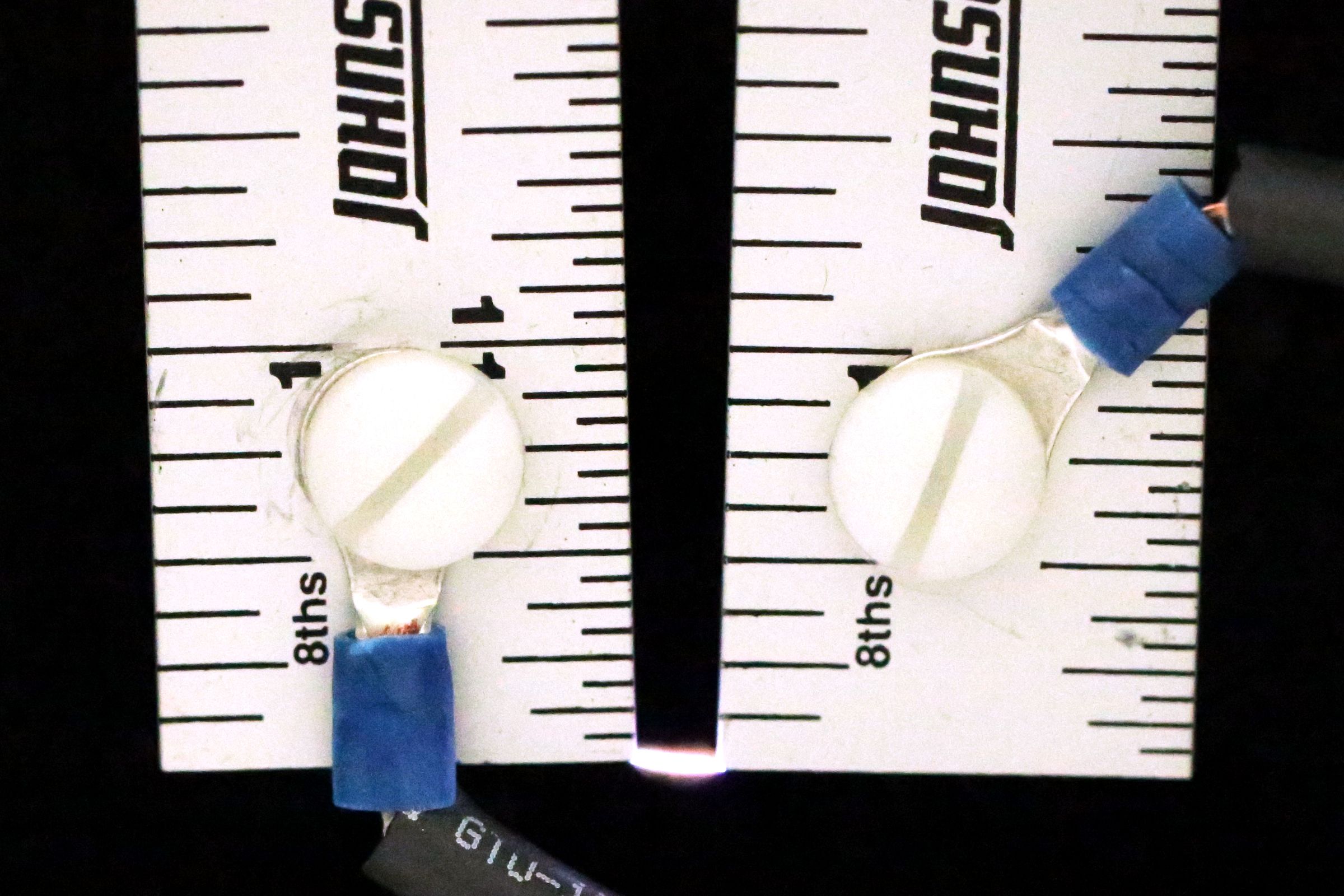

Step 16: Fine Tuning It
Once the case is closed and the frame is set upright, you may plug it in and see if it works.
The arc should start to rise. If it just sits at the bottom, it will start to heat up and melt the metal. Unplug it immediately. The rulers need to be re-positioned.
First things first, whenever you are going to open the frame and work on anything, drape the unplugged end of the power cord over your shoulders. If it is, you will always know that it is not plugged in and it is safe to work on.
Open it back up, slightly tweak the position of the rulers, and then fully reassemble it. It is now safe to plug it back in, and see what happens. If the arc rises to the top and then breaks, then great! You are done. If not, carefully repeat the process of tweaking it until it works.
