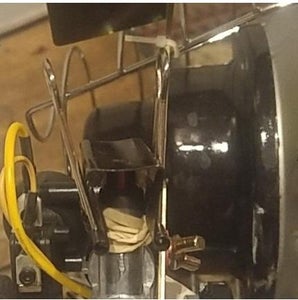

Step 1: Wrap Elastic Band
wrap a elastic band over the red ignite button then roll it over its metal arm behind the button, twisting it over double or even triple loop (depending on elastic band width), to ensure it is tightly wrapped over the metal frame, as indicated in the red arrow pointing to the brown elastic band in the first picture.

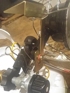

Step 2: Attach Metal Paper Clip
Open up and attach a metal paper clip over the wrapped elastic band, press it down hard over the button and clip it over the elastic band, make it is tightly in place over the red ignite button to ensure it is always pressing down on it, as shown in the second picture.

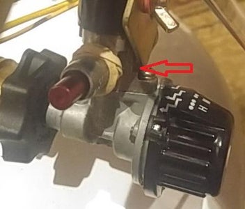

Step 3: Test Clip Tightness Over Button
To test this metal clip is in tightly in place over the button, just slightly open the propane tank by turning its top knob counter-clockwise. You should hear some slight hissing sound to ensure the propane ignite button valve is always being tightly pressed by the clip. Then turn off the propane tank knob turning it turning clockwise, ensure it is firmy closed.
