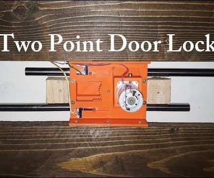

a good working printed electric lock
Step 1: Design
after a lot of shapes in tinkercad i made this
Step 2: Print It
print the .stl files (modify the parts for solenoids and shaft if needed)
Step 3: Parts
my solenoids are 16mm diammeter and 20mm height. the shaft is 6mm diammeter the parts are from an old laser printer
Step 4: Glue Them
glue those items with epoxy glue
Step 5: Shaft
add the shaft,a spring like the pics, then add those cylinder items to the shaft (glue them with instant glue if needed)
Step 6: The Other Shaft
modify this part for your shaft if needed
Step 7: Lock-unlock
connect those parts together with some screws (this must can move easily)
Step 8: The Other Spring
add like the pics the part for the other spring
Step 9: Diodes
add diodes to the coils to protect your control circuit
Step 10: End
its ready this work with 24v dc.
thanks for viewing this post
make it better, and let me know about your tips and suggestions
