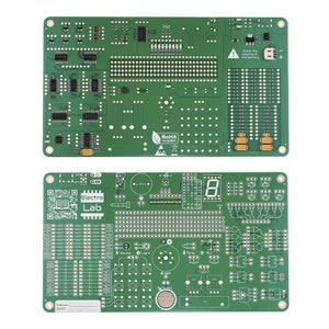

Instead, I kind of mixed both concepts in a compact, yet powerful, solution: the ElectroLab, a 175x100mm board that had on the top side the (male) pins and connectors for each component and on the bottom all the SMD components routed to each corresponding pin and ready to be used.
First generation (2016) of the board on the left, second generation (2020) on the right

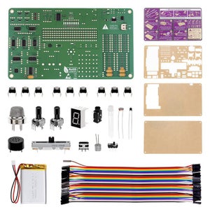

The ElectroLab kit, contains:
  • 1x ElectroLab SMD preassembled board
  • 1x ElectroLab Stencil PCB
  • 3x different transparent acrylic plates *
  • 1x 1000mAh LiPo battery *
  • 4x Screw set (screw + washer + nut)
  • 1x THT components set
  • 40x Female-to-female jumper wires
*Are optional

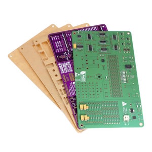

Step 2: Screws Positioning
Mount 2 screws on the ElectroLab diagonally, with the screw head coming from the bottom side (the one with SMD components) and add a nut on the top side of the board (the one with the QR code).
Step 3: Pins Placement
Start with the pinheads. Place all the pinheads on the ElectroLab top side. Make sure you introduce the short side of the pin on the PCB.
Once you have mounted all the pins, place gently the Stencil board over it. Be patient, some pins (like the individual pin from the signal generator or the Gas sensor) may become trouble rebels. Once they are all in place, screw the other 2 nuts to the screws to secure the two boards together.
Step 4: Pins Soldering
With the pinheads correctly secured, proceed to the soldering of each individual pin on the ElectroLab’s bottom side. Pay special attention to those solderings close to SMD components to avoid any damage.
Step 5: Stencil Removal
After soldering all the pinheads, the screws can be removed and the boards separated. Be patient and don't force the removal or you might bend some pins.
