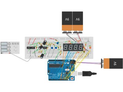

Constructing and Testing the Integrated Circuit:
Once all three stages have been completed and verified individually, it is time to test the integrated circuit as a whole! The breadboard image above shows the three stages physically built next to each other, and the oscilloscope image displays the simulated ECG circuit. The result depicts a clean, ECG signal with evident P waves, T waves, and the QRS complex. Additional ECG functionality assessment can be obtained by testing on human subjects while they are sitting down/inactive. When doing so, ensure that a 9V battery is used, and that electrode placement follows the standard 2 in opposing ankles, and 1 on the wrist. The ground electrode is the one placed on the side of the body with the electrode on the wrist (ex. right ankle = ground electrode, left ankle = positive electrode, and right wrist = negative electrode).
Step 5: ECG Signal Plotting and Automatic BPM Readout on Arduino
Arduino code is attached.
To obtain automation in heart rate recording and blood pressure readout, the following Arduino code can be used, resulting in a simulation of ECG signals and the corresponding BP measurement, as can be seen on the images above.
