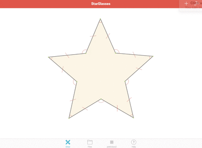

Step 2: Make a Star
Stars are easy to make in Zotebook. The Same Angle and Same Length gestures turn a handmade shape into a perfect shape.
Once I have a perfect star I can adjust the shape by selecting a single point to shape it for Rock Star Glory.
